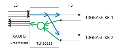

Refer to the below diagram for planned implementation,
Configuration details:
TX (LS to HS): XAUI on channel A (LSIN A) is to be replicated on both 10GBASE-KR TX (HSTXA & HSTXB) as indicated using blue connection lines.
 RX (HS to LS): One of the 10GBASE-KR (HSRX) received is to be routed to XAUI channel A (LSOUT A) as indicated using green connection lines. This selection is to be done using pin control to avoid MDIO delays. The selection should be possible back and forth using the pin control.  For example, LSOUT A should be able to select HSRXA or HSRXB through pin control, if the current selection is say HSRXA, it should be able to change later to HSRXB and vice versa through the pin control.

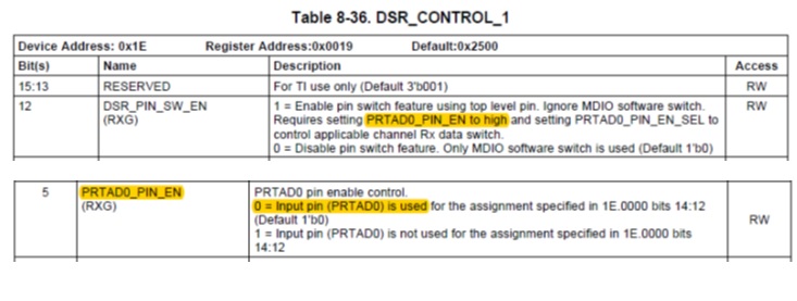

set PRTAD0_PIN_EN_SEL[2:0] to 011 (channel A RX Data switch, RX is selected since only TX or RX can be selected for pin control, TX will be under MDIO control)
set PRTAD0_PIN_EN to 0 (Input pin PRTAD0 is used for the assignment specified in 1E.0000 bits 14:12)
set DST_PIN_SW_EN to 0 (MDIO for TX)
How can we configure TLKL10232 to replicate the data on LSINA to HSTXA & HSTXB?
DST_DATA_SRC_SEL[1:0] is found common for channel A & B. Is there an option to set DST_DATA_SRC_SEL[1:0] for channel A to same channel LS input & DST_DATA_SRC_SEL[1:0] for channel B to alternate channel LS input?
Set DSR_PIN_SW_EN to 1 (pin control for RX).
However, description for this bit is contradicting with the description given for register bit PRTAD0_PIN_EN. Here it says set PRTAD0_PIN_EN to 1 for using pin level control whereas the description for PRTAD0_PIN_EN says it must be set to ‘0’ for having pin level control. Refer below snap shots for details,

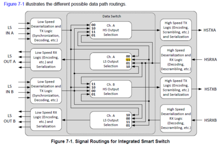

Also the source for RX switch is bit confusing. Planning to use same channel HS input when PRTAD0 is HIGH and alternate channel HS input when PRTAD0 is LOW as per the data switch diagram shown below.
However, the register description shows alternate channel HS output as one source instead of HS input.

    I found a similar post(e2e.ti.com/.../1165322 in the forum related to the contradicting setting regarding PRTAD0_PIN_EN. As per this post, PRTAD0_PIN_EN must be set to '1' to use pin control. Please confirm this (TI should have updated the data sheet to reflect this!).
    Another clarification required is for the DST_PIN_SW_SRC setting. 0x1E.00017 says if this field is set to '11', alternate channel HS output will be selected, where as it should be alternate channel HS Input.

    Sorry for the delay. Regarding the PRTAD_PIN_EN, the bits 14:12 description is right as the e2e post that you mentioned.
    For the data switch feature (DST_PIN_SW_SRC) you are right, according to the block diagram of Signal Routings for Integrated Smart Switch in Figure 7-1, the value '11' for this register means "select alternate high speed input". I need to request this change in datasheet, thanks for your catch.
