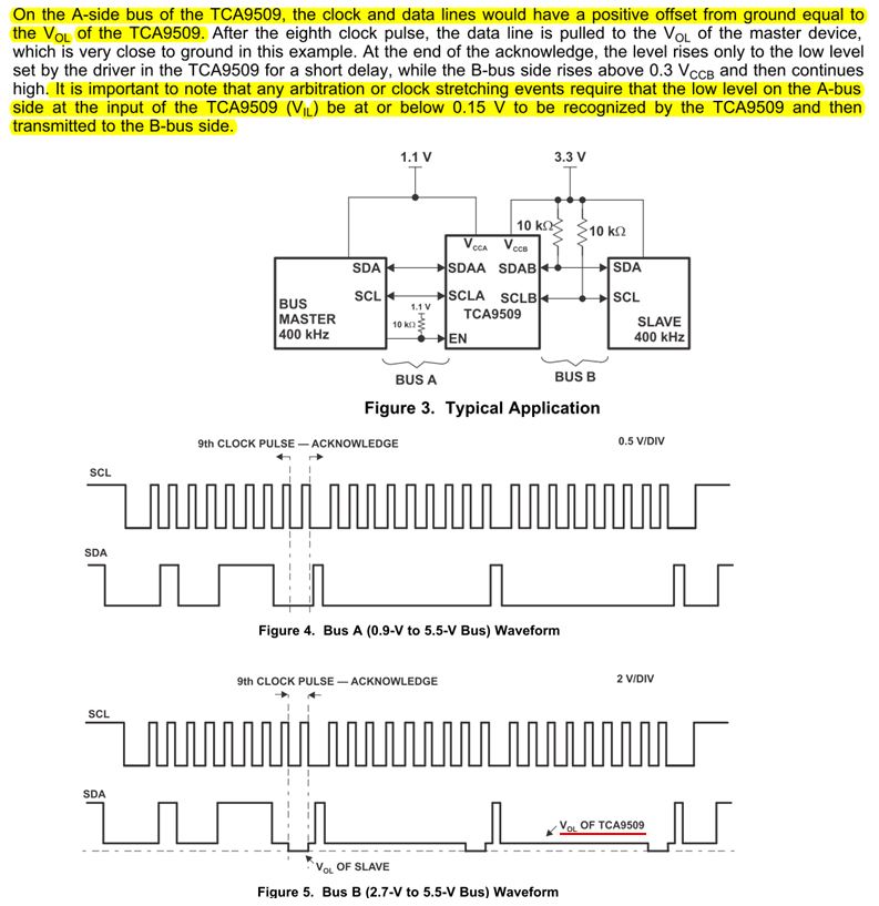

Hi Team,

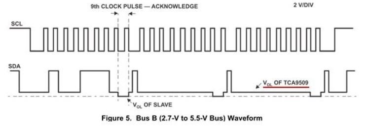

In the datasheet, it says that A-side bus would have the offset from ground. However, looking at the waveform information (Figure 5), B-side seems to have the offset. Which is the true description ?

    The TCA9509 does not have a static voltage offset on the B-side of the device, the unique thing about our 9509 device is that it contains a current source on the A-side which causes the operation shown in those waveforms. That pedestal you are seeing on the B-side is due to the parallel combination of slave devices pulling down on the SDA line.

  • Hello Siby-san,
    Please allow me to clarify. Doesn't this Figure 5 show that B-side of TCA9509 has a offset for VOL ? I thought this waveform is for A-side instead of B-side.
    I have been supporting TCA9517 and this figure seems to be exactly the same with the one on TCA9517 datasheet. However, TCA9517 has a opposite spec compared to TCA9509 that VILC is on B-side of the device.

  • Kawai-san,
    You're analysis of the differences between TCA9509 and TCA9517 is correct. You can think of them of opposites almost.
    TCA9517 has a static voltage offset on the B side while TCA9509 has a current source on the A-side.
    This can be attributed to the flipped waveforms.
