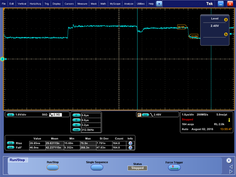

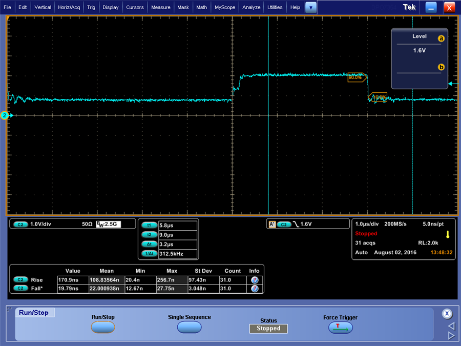

  • I have some obtained some scopes shots of the CANH and CANL lines. The scope setup is a little overkill but it was the easiest one to get a hold of.

    This is a shot of normal CAN bus traffic (yellow is DIff, blue is CANH, purple is CANL):
    Looks relatively fine. Then I caught this shot:
    So either a runt pulse or a reflection showing up there, with the sharp edge, looks more like an intentional beginning of a pulse to me and not a reflection.
    This was the CANH single ended weird pulse:
    And this was the CANL shelf edge:
    The last image looks more like a transmission line impedance issue. I have measured the term resistance on the CANH/L lines, and it's 61.2 ohms, pretty close to what it should be.
    Any ideas from looking at these scope shots?

    It's tough to say. When the dip is close to the edge (as in your last picture) it does look like a reflection that you might expect from a termination mismatch, but it could also be the same runt pulse that is showing up later during the dominant periods. (I would guess it's the second option in this case given that the total termination resistance is close to 60 Ohms and the stub lengths do not sound overly long.)
    Was the overall bus configuration (number of nodes, stub lengths, etc.) the same for all of these scope captures? What needs to change in order to get the issue to show up?
    If you wanted to check more into the runt pulses, you should be able to probe the TXD pin of whichever transceiver is sending the data during this test. If you see TXD toggling then you would at least know that this isn't something resulting solely from the physical layer (cabling architecture, noise coupling, etc.).
    Have you looked much into the configuration of your controller? I mention this since the analog signals look mostly OK (with the exception of the runt pulses - they are the right amplitude, transition at the right rate, etc. If the timing parameters of the controller aren't optimized for this bus/speed, though, it may explain the error rate.
    It looks from the waveform shown above like the "dip" is following the arbitration period of the CAN frame. (This period has higher signal amplitude due to multiple CAN drivers outputting a dominant level at once.) Is this always the case, or do you ever see it occur at different times? If it always follows arbitration it may help give a clue as to what is going wrong.
