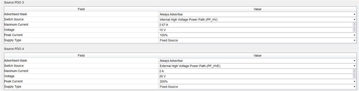

I have configured PDOs to support 40W system. as below. ( I have attached pjt file and images as well)
40W_BILLBOARDING_32UD.zip

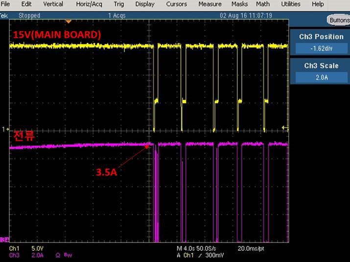

after I set 2.67A for 15V PDO, I was able to see about 3.5A current limit on the board. can you check whether it is well configured?

    I see the VBUS drops to zero when the current is 3.5A (OCP may be hit) and then restart again. Are you issuing any 'Gaid' command to TPS65982 when this happens? Do you see this behavior with latest TPS65982 Application Customization tool tool too?

    the OCP occurs about 3.25A. and I set the value 2.67 as a maximum current.

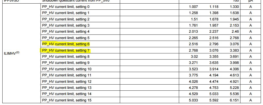

    which current limit setting is applied on the table below? I have attached the pjt file from tool V2.8 as well.08162016_40W_BILLBOARDING_32UD_20V.pjt

    The code for setting the OCP limit sets as per the ILIMPPHV table you have pointed out. Since you have two PDOs using the PP_HV, it will take the maximum of the 'Maximum current' settings in it. So since PDO 2 has a 'Maximum current' setting for 3A and PDO3 has a maximum current setting for 2.67A, the PP_HV Switch would select the setting 9 instead of setting 7. That is why you see OCP hitting at 3.55A since setting 9 has the Min, Typ and Max values of 3.02A, 3.355A and 3.691A respectively.
    Can you set the PDO2 Maximume current to 2.67A and check again?

    The way I understand is that 'Current setting min value should be higher than PDO current. Among satisfied settings, the lowest value setting is chosen'

    • Yes, your understanding of Over-Current Protection (OCP) automatic selection is correct
