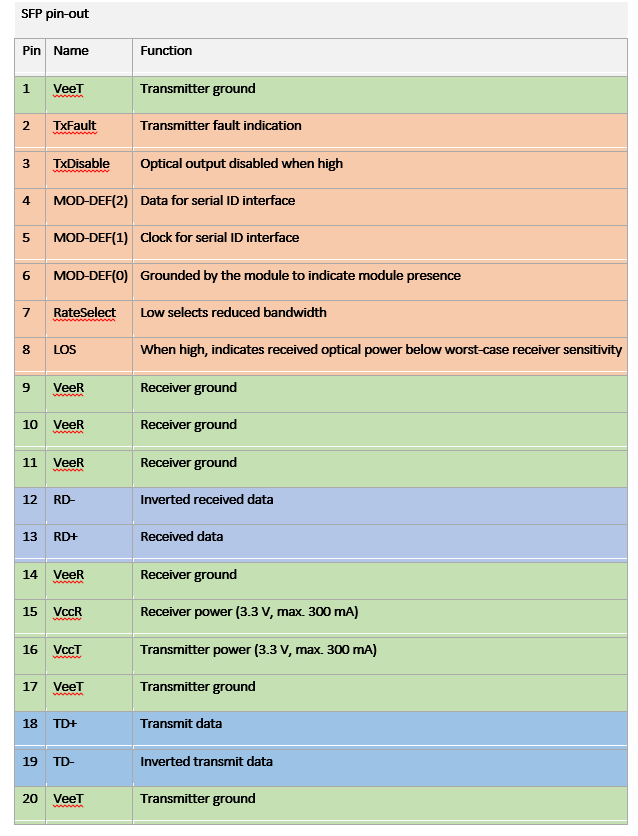

    My main question is that as you already know an SFP connector has 20 pins  as shown below; I will connected the green highlighted pins to VCC and GND on board respectively, and the blue rows are our data. However I'm not sure about the orange highlighted rows. Should I pull up (down) these pins? or I should consider other things?

  • Hi Mike,
    No worries, this stuff can get pretty confusing at times so I understand.
    Here are the pins you are not sure about:
    2. TX_Fault
    3. TX_Disable
    4. MOD_DEF(2)
    5. MOD_DEF(1)
    6. MOD_DEF(0)
    7. Rate_Select
    8. LOS
    TX_Fault can be left unconnected if you do not want to use it.
    TX_Disable when pulled down will enable the transmitter and when disabled or pulled high will disable the device. If you do not plan to have a controller dictate operation, I would suggest you pull this down so that the transmitter is not disabled, but this is up to you.
    MOD_DEF[2:0] these are for communicating with the fiber module, up to you if you want to use them, but if not used, you can leave them unconnected.
    Rate_Select is not connected so you can leave it unconnected.
    LOS will indicate loss of signal. This usually requires an external pull-up to VDD. Logic '1' indicated loss of signal and a '0' indicates normal operation. For this you can use the FXSD pin, otherwise you can leave it unconnected since the PHY supports Far-End Fault detection.
    For the RD/TD pins, I would suggest you use 0.1uF isolation caps. Put 50 ohm terminations between the PHY and caps on the TD pins. Put the 130/80 ohm terminations on the RD pins between the PHY and caps.
