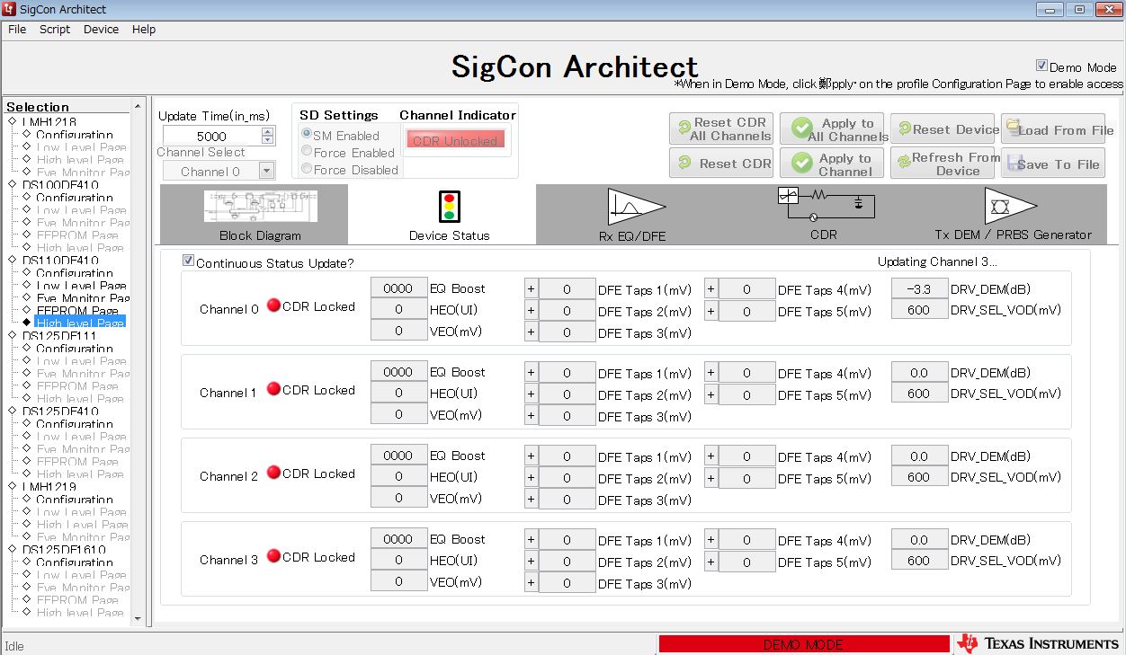

SigCon Architect seems to have some bugs in displaying DEM level in High Level Page. Could you please confirm ? I believe the datasheet value is true.

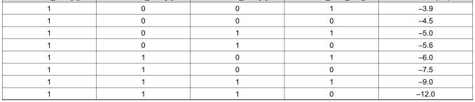

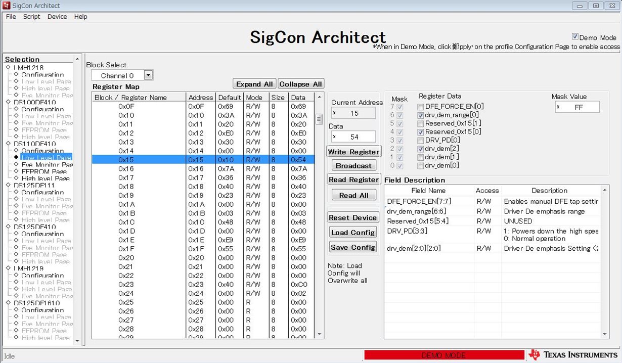

DEM setting does not match the value in the datasheet Table 13. Example below should show -3.9dB in High Level Page, as REG 0x15 = 0x54. It seems other setting also does not match the value in Table 13.
