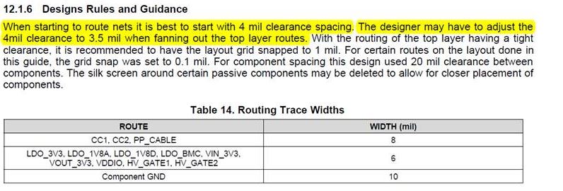

Hi Team,
For the TPS65983, did we have the recommended impedance layout suggestions for customer layout engineer?
How to get the 4mil or 3,5 mil suggestion value?
Scott
