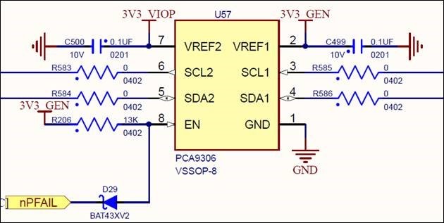

Hi Support,

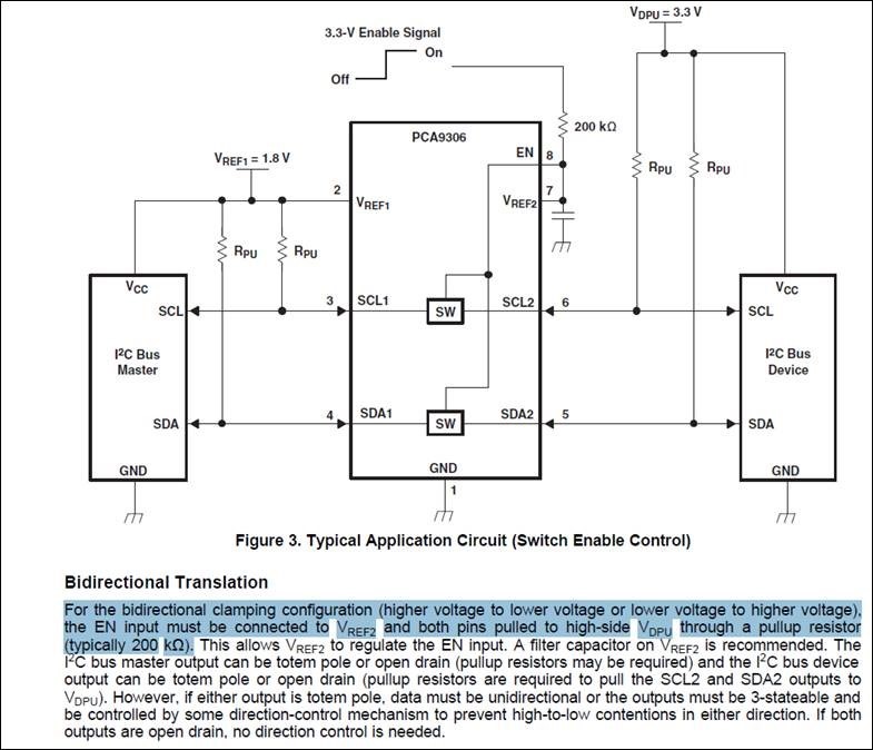

The PCA9306 recommends connecting EN and VREF2 together with a 200kohm pull up resistor.
Please advise if there are any potential issues if VREF2 is connected directly to a power rail.  Refer to the schematic snapshot below.
Thanks.
