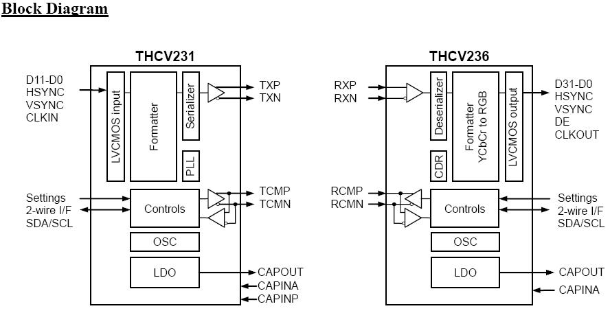

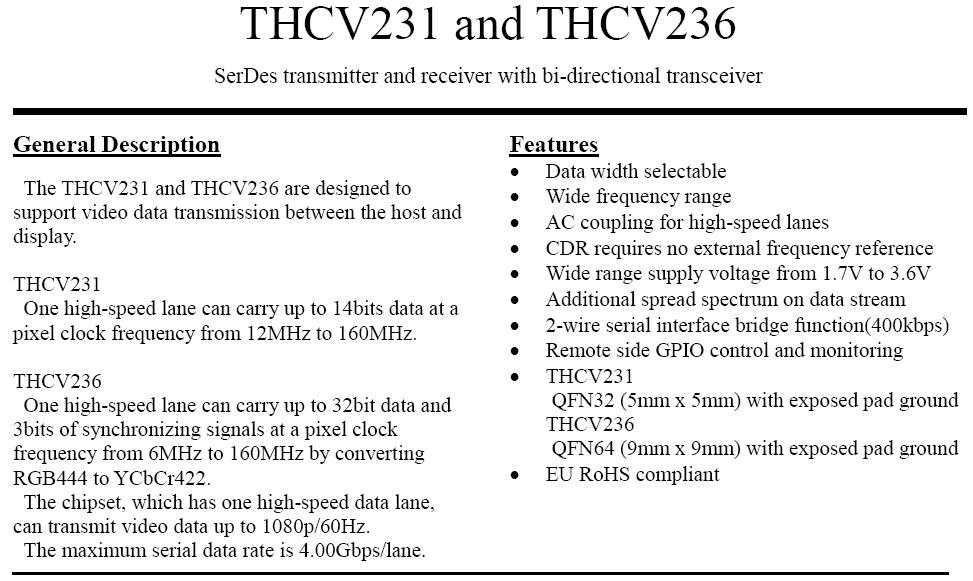

Hola,
Does TI have a solution which similar with THCV231 and THCV236 below and can support HiSPi? Thanks ~

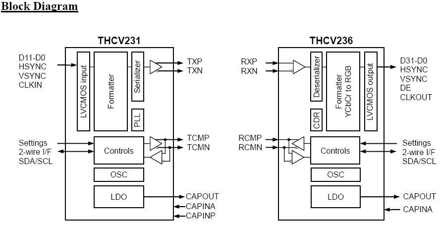

Hola,
