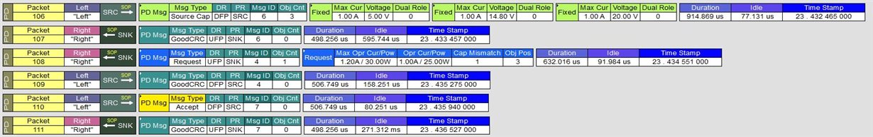

Below my test with sink PDO 5V / 2.4A, 14.8V / 2.0A, 10.8V~20V / 1.2A, auto negoitate priority by voltage.(1.11 FW).
It looks like TPS65982 still request 20V1A with cap mismatch set high and turn on sink path. System charger would then see 20V in this case and start to sink current. Should be better to turn off sink path in such case

Hi Sam,
The Sink can still ask a PDO from Source if the voltage given in the Source capabilities PDO matches one of its Sink PDO. Now since the Current given in the PDO doesn’t match the Sink sends a RDO request with the ‘Capabilities Mismatch’ bit set high. This is the behavior in Auto-negotiate Sink mode.
If you want to sink to not request any RDO, then the Sink can be operated in Sink intrusive mode. In this case the Source PDOs will be sent to EC by the PD controller and the EC can decide and let the Sink PD controller know which Source PDO should be requested.

  • Hi Sam,
    Can you set the peak current capacity for each Sink PDO to  100%? Then OCP should be hit when 3A contract is established  and more than 1A is drawn by the sink.
    Note: even though a 3A contract is established the sink may not be drawing 3A current. Is there is no load attached to sink the current drawn should be very less(<1A). Only when the current drawn by sink goes above 1A the OCP will be hit.
