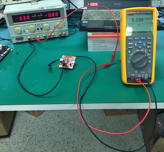

  • Hi Arun,

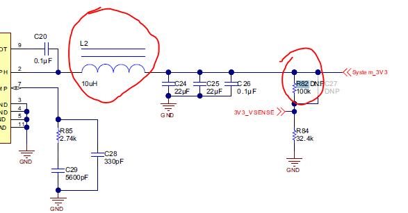

    I measured on EVM without barrel jack connection, DC power supply to VIN_3V3 as below photo. I have removed L2 and R82, set all GPIO as unused and set all dip switch to pull down on EVM, then the power consumption should be only from TP65982/982D VIN_3V3.
    Anything else I should modify from EVM to get the right power consumption? Thanks!
    Sam

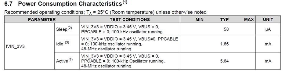

    TPS65982D spec data is probably not final, but for TPS65982
    From spec idle mode is 1.66mA with VIN_3V3 = VDDIO = 3.45V, power consumption = 5.72mW
    Bu the real measurement is 2.57mA with VIN_3V3 = VDDIO = 3.3V, power consumption = 8.48mW
    Is it within the variation of the spec? Because the spec only show typ value, no minimum and maximum
    Thanks!
