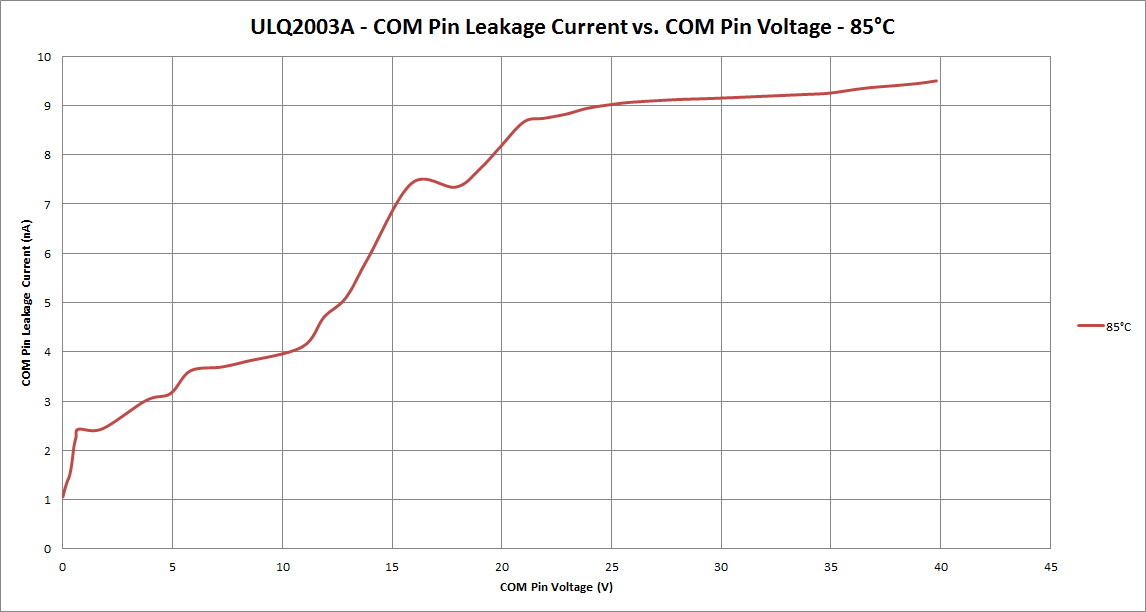

Dears;
Do we have the data about the leakage current that will flow through the COM pin for 28V at 85 Deg C ? I didn't have the related data or curve in datasheet. Very appreciated.
Best regards
Kailyn
Dears;
Best regards
Kailyn
Dear Michael;
All right, thank you very much for your reply,and very very appreciated.
Best regards
Kailyn
