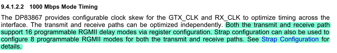

I understood that user can set delay setting by using following both two methods.
1. By using register (16 proggramable setting)
2. By using strap (8 proggramable setting)
And also, user need to set "RGMII_TX/RX_CLK_DELAY" bit to "1" to enable register setting.

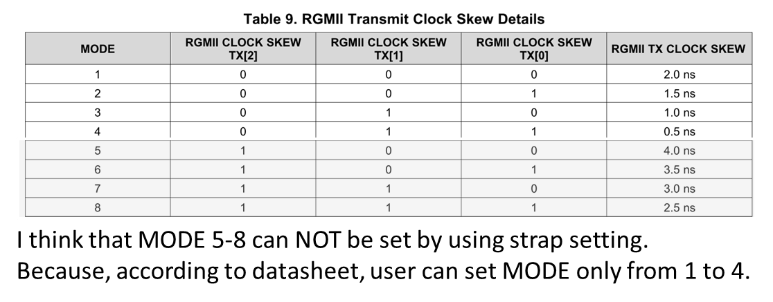

    1. Delete strap setting (Table 9. RGMII Transmit Clock Skew Details)
    2. Delete following highlighted sentence.

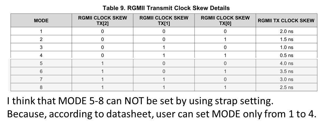

    In addition, I noticed below.  I think that MODE 5-8 can NOT be set by using strap setting. Because, according to the datasheet, user can set MODE only from 1 to 4."
    Modes 1 to 8 in Table 9 do not refer to the strap pin modes 1 to 4.  The mode # in table 9 is only for reference and the way you enter the modes in table 9 is to set the CLOCK SKEW bits using strap pins.

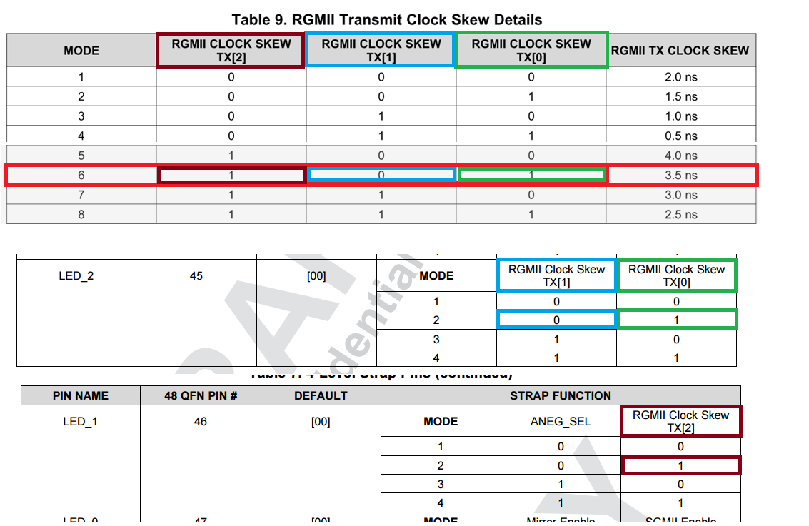

    For example, I have put the following diagram together illustrating how to use MODE 6 (this is more accurate to say "configure TX clock skew to 3.5ns) for TX delay.
    See that in order to set MODE 6 TX delay, the customer would need to use 2 strap pins to set the appropriate bits.  The bits in Table 9 are color coordinated to indicate which bits need to be set on the strap pins.
    Depending on the delay set in the two straps in the illustration, the bits for RGMII_TX_DELAY_CTRL/RGMII_TX_CLK_DELAY will change.

    I understood relatationship b/w Table9 and Table7.
