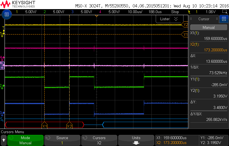

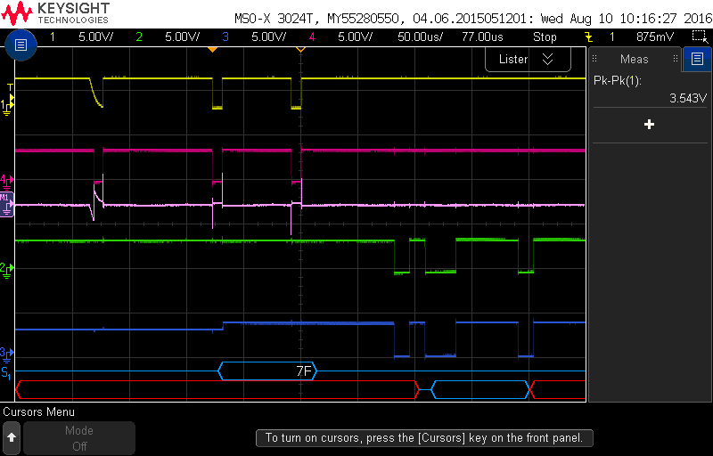

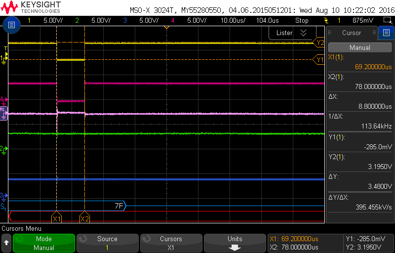

    I captured the waveforms of the control/UI com’s during failed update, treating the RS485 coms as a black box
    • 1(YELLOW): control TX
    • 4(RED): UI RX
    • 2(GREEN): CONTROL RX
    • 3(BLUE): UI TX
    • M1: MATH FUNCTION [CONTROL TX – UI RX]
    Also attached are measurements of the frequency. The control TX has a slope on the first bit that is always present, but the RS485 looks to be filtering this out. UI TX (BLUE) voltage raises slightly, but does not show on the control board RX(GREEN). The control board sends the correct upload start byte (F7), and the UI returns the correct acknowledge byte (79), but the baud is slower. The baud rate of the control board is always ~1.69x the baud returned by the UI board. We have tested different baud and come up with the same ratio. Next I am going to bypass the RS485 to show the upload acknowledgement when succesful.
    For the 3 images attached, the first is the entire communication sequence. The second is the control TX frequency measurement (115.2Kbaud). The last image is the UITX (~74Kbaud)
