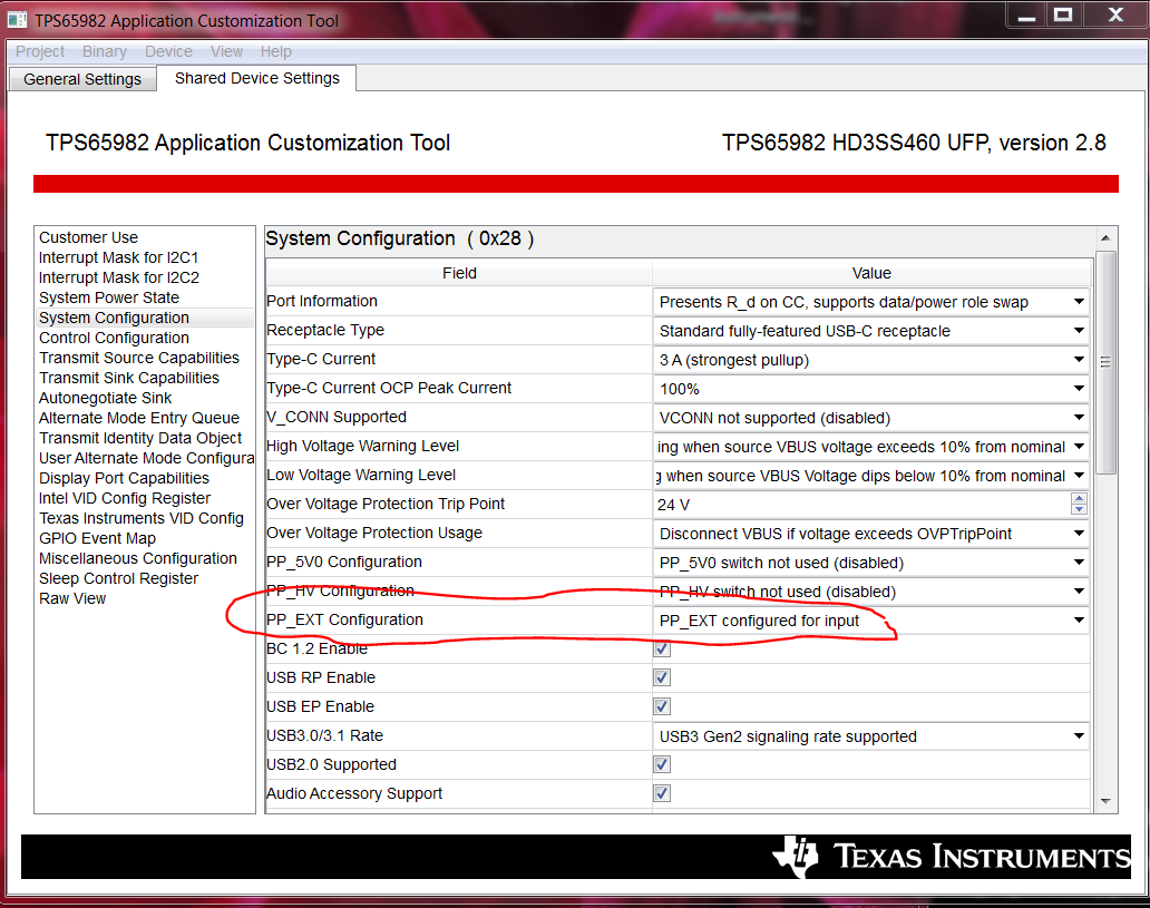

  • On the sink side one path needs to be configured as input to sink power from VBUS. Like in below example PP_EXT is configured for input. In the experiment you mention, do you know which path is configured for sinking power?
  • Atiq, I guess it's PP_HV but i'll get confirmation of that. Do you mean there is a path between HV_source and external power without J6 jumper?

    Since RPD_G1/2 are tied to CC1/2 by default on the TPS65982-EVM, this means Dead Battery Mode is automatically supported (assuming no PCB modifications have been made).
    Regardless of the FW Config ID #, the Sink FET path will be enabled for a Type-C connection on either PP_EXT or PP_HV based on the BUSPOWERZ setting (tied to GND by default because S2 is un-populated, meaning PP_EXT is enabled in Dead Battery Mode).
    As long as the Barrel Jack is not applied at J4, only BUSPOWERZ will matter for your tests (the TPS65982 will remain in Dead Battery Mode). The FW, once loaded, cannot modify the Sink FET path enabled by BUSPOWERZ while the EVM remains in Dead Battery operation.
    The voltage on VBUS will depend on the capabilities of the Source board you are connected to via the Type-C cable. I would advise marking an EVM as the 12V PD Source with a piece of electrical tape to ensure it is not swapped out for an EVM that does not have Source capabilities.
    Assuming the Source EVM is static and the Config ID # of your Sink EVM is un-changed (S1, switches 1-4), VBUS should always resolve to the same voltage after USB PD negotiation (ideally, 12V in your test).
