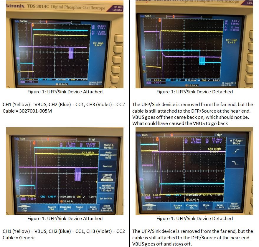

  • Hi Arun,
    Thanks for your reply.
    I meant the UFP/Sink device is removed from the far end of the cable, but the cable is still attached to the DFP/Source side.  Yes, I agree when the UFP/Sink device is removed, VBUS should be shut off, but I'm seeing it turns off then come back on.  I'm not sure what's making it turn back on.  Attached are some waveforms.

    In the Issue plot 2, I see the CC1 line toggling. That is not expected. Also Can you send me the plot where the far end device is unplugged?  I don't see that in plot2.
    Can you use another Type-C cable from a different vendor and check?
    Arun

    Sorry, I forgot to update the figure numbers. Figures 1 & 2, from left to right, I used the same cable (PN: 3027001-005M). Figure 1 is when the cable and UFP/Sink device are attached. Figure 2 is when the UFP/Sink device is removed/unplugged, but cable still attached. So I think figure 2 is the one you want to see for your first question.
    Figure 3 & 4, I used a different cable, generic brand I bought from Amazon. Figure 3 is when the cable and UFP/Sink device are attached. Figure 4 is when the UFP/Sink device is removed, but cable is still attached. I've also used an Apple type-C and a Google Nexus type-C cables, and they worked as this one. At this point, I'm starting to believe there's something with this particular type-C cable. Let me know your thoughts.
    Vichet
    It looks like a cable issue. Yes, I was mentioning Figure 2 when I mentioned plot 2.

  • Arun,
    When I disable the V_CONN Supported feature in the TPS6598X Configuration Tool, it works. Before I had it set to VCONN as DFP Only.
    Which is the correct setting for this?
    Vichet
    The VCONN supply for the Cable is taken from the VBUS on the DFP side. Hence if VCONN is enabled with 'VCONN supported as DFP/UFP,' then VBUS volatge wont drop even if the Far end device is removed. If VBUS voltage drops to zero then the active E-marker cable wont respond to SOP' or SOP'' messages.
    You can disable VCONN id you are not using a active cable.
