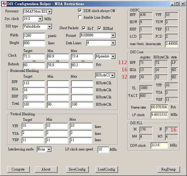

    Currently, I could see the normal output screen or show the test pattern. (System Clock 19.2MHz, MIPI DSI clock 213MHz, LVDS clock 71 MHz)
    However, in most of the time, IRQ register (0xE5) will show 0x81 (CHA_SYNCH_ERR, PLL_UNLOCK) in boot up.

    I need to understand how the data is provided from the OMAP to correctly configure the DSI input end. Per current configuration, the line time from the GPU must match with calculated by the DSI tool . The timing requirements can be viewed using the DSI Tuner tool on the output tab.
    The error indicates vertical/horizontal syncs are not being detected correctly on the DSI input. This typically means fundamental timing/config issues which I cannot tell until I fully understand DSI configuration from the OMAP.
    The PLL_UNLOCK is the CLK issue, but since it sounds like you are getting test pattern correctly, it may have been set during the intial setup. You will have to write 1s to the status bit to read back the latest status. If you continue detecting the PLL_UNLOCK error, the input CLK likely has an issue. Is the same error detected in test pattern generation mode?

  • Hi Joel,
        Thanks for your reply.
        1. I attached the configuration and LCD specification for your reference.
            I use the RED values in my codes, not the suggest values from the DSI configuration Helper 0.6.4595.
             I am using DSIPORTA_LANE*X, DSIPORTA_LANE*Y to connect between OMAP5 and SN65DSI83. (* = 0 ~ 4)
        2. I still see the PLL_UNLOCK error while I test it in pattern generation mode.
