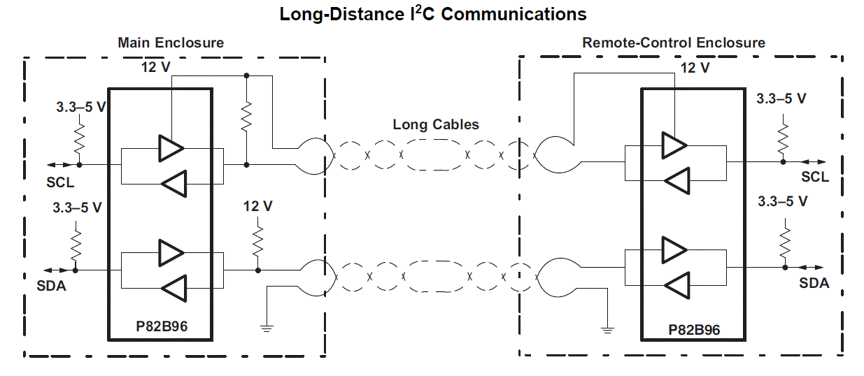

I have a microcontroller as a master and ten I2C chips.
I cannot know the capacitance of the bus.
What is the best mode/way to connect the PCA9515b :
1.As the first I2C connection after the microcontroller and after it the others ?
2. At  the middle of the signal chain, like after the 5'th chip ?

    Do you have a schematic or block level diagram to reference?  Selecting the location of the buffer/repeater is dependent on a variety of factors.  Generally speaking you want to distribute the capacitive load on the i2c bus based on the drive of the master and that of the repeater/buffer.  Lets assume the master has the same drive strength as the PCA9515B for the sake if simplicity.  If that is the case, you will want to try and distribute the capacitive load evenly between the two.  It that isn't the case than you will want to proportion the capacitance load such that the stronger drive strength take more of the capacitive load.
    Capacitive loads depend on a variety of things.  The ICs have capacitance and the trace have capacitance.  Pin capacitance is usually defined pretty well but the trace capacitance will be a function of trace width, length, dielectric strength, and the distance from the trace to the ground path.  If you are doing the layout some tools can extract the parasitic's.  If you give information about your system I can help give you a ball park figure.

    If the cable is the majority of your capacitance than you may want to consider P82B96/715 where it works in pairs where the cable is buffered on one board at the end of the I2C chain before it connects  through the long cable to the second board.
    This might be over kill in your application, especially if you have a battery application because these parts have very strong drivers.  You could also consider using the TCA9617B which allows for using more powerful pull-ups.
