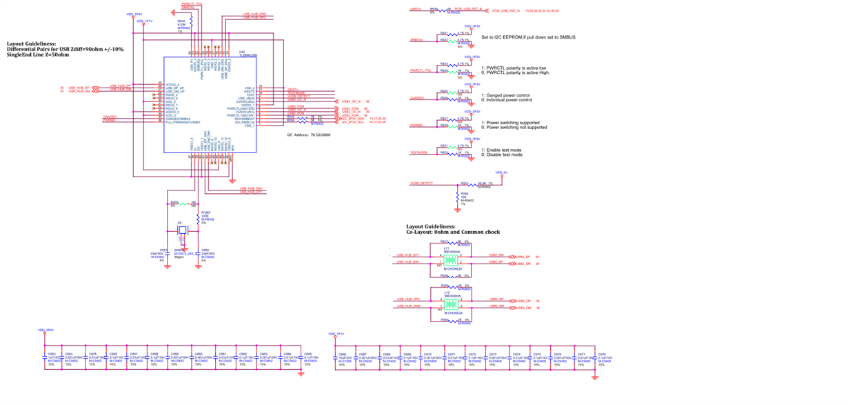

We have use TUSB4020BI,  will do TUSB4020BI compliance test.
We sure have input, after passing TUSB4020BI, there are no output now.
I'm not sure have any control or setting need config?
By the way, we saw the pin10 is test pin, Should we need use this??
Looks pin 10 is for factory use, what is this pin function and how to use it??
Could you help review schematic again and share experience for us??
Many thanks for your kindly help
Schematic as below:

    TEST terminal is for Texas Instruments factory use, you should pull this terminal down for normal operation.

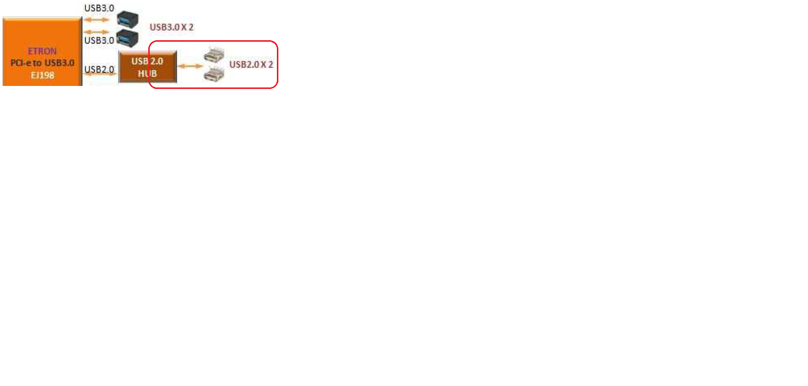

    But in USB compliance test, we sure there have input signal from TUSB4020B, but no waveform at TUSB4020B output.
    The signal like as below
    The comment source by EJ198
    Total have four USB road, we use to comment USB2.0.
    The USB3.0 Port is normal send waveform at USB compliance test
    But after pass TUSB4020B, It's doesn't work.
    It's surprise me because USB2.0 port could read/write, but couldn't send waveform under compliance test.
    We would like to know how to fix this issue and how to do USB compliance test. at TUSB4020B ??

    The USB3.0 compliance patters will not pass-through a USB2.0 Hub.
    Are you sure you are sending USB2.0 compliance packets?
