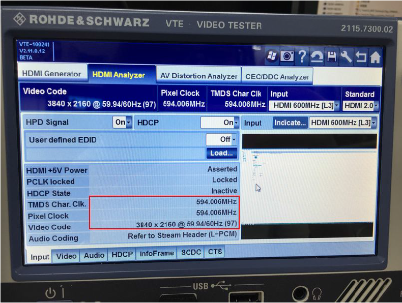

The tset environment as below.
PC source : WIN8 PC
Monitor : Acer S277HK
We use PC connect with monitor can display 4K2K@60Hz as below.
But We add DP159RGZEVM between PC and monitor.
We only get 4K2K@30Hz as below. Need we modify which one of settings on EVM? Or have IBIS for DP159 can be provided?
Thank you for your great support.
  • Hi Hugo,
    Was the first image taken from PC to Monitor using a DP cable?
    Was the second image taken using a DP cable from PC to EVM, then an HDMI cable from EVM to monitor?
    If this is the case, your PC supports DP++ with HDMI1.4, when you have a DP connection you can have DP1.2 with data rates up to 5.4Gbps per lane(4 lanes). When you use DP++ you are limited to HDMI1.4 which cna support up to 3.4Gbps per lane(3 lanes), this would be the reason why the refresh rate is reduced.
    Your PC should be able to tell you what resolutions and refresh rates are support, you cna confirm there that when DP++(DP159EVM) is used there is no option for 4k 60Hz.
