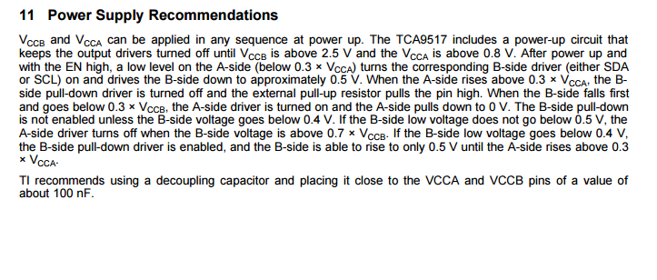

Customer is considering PCA9306, TCA9517. Is there a constraint about Power Sequence? At first, could VREF2 only supply before VREF1 ?
