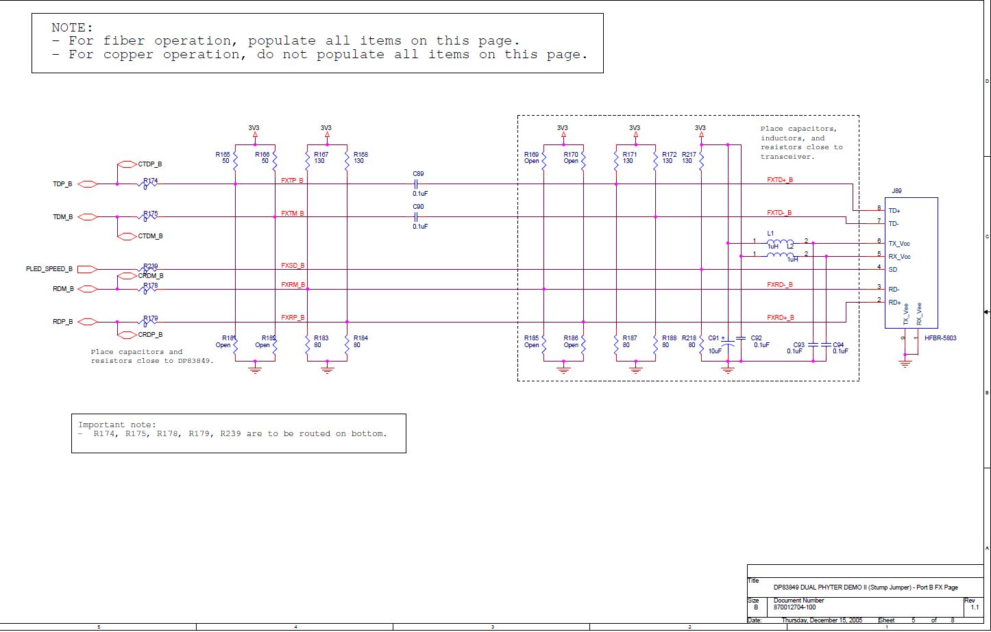

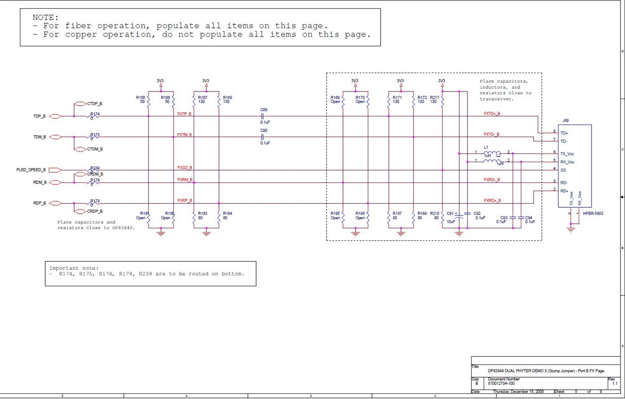

I have a question about LVPECL interface between DP83849IF and HFBR-5803.
According to the reference design,
after AC coupling, 130Ω is connected to Vcc and 80Ω is connected to GND.
In case of AC coupling, 80Ω is connected to Vcc and 130Ω is connected to GND, isn't it?
