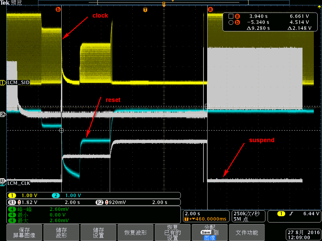

  now,used 2046B to extend 3 ports usb , circuit as the attach,similar to the design about the 2046B. mount R56
seems three ports are not reconginized by host usb target , i will raise pull up resistor to 15K or 100K on the reset pin to give more delay time,change R61&R62 to 15K and change all capacities on DM&DP pins to 22pf.
 orso change damping resistors to 30 ohm
can you help analysis for me   ths
