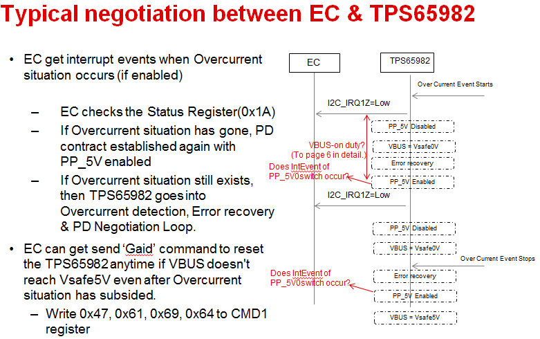

Could you give answer on below questions about the motion when Overcurrent happens?
1.
What is the maximum time from [IRQ issued] to [PP_5V Enabled] when Overcurrent happens as following diagram? (Red color’s question)
2.
If Overcurrent situation has gone, PD contract established again with PP_5V enabled.
Is the interrupt event of [PP_5V0switch] generated when the PP_5V is enabled after Overcurrent has gone? (Red color’s question)
3.
What is the maximum time from [Gaid command issued] to [IntEvent occur]?
4. Are all the PDC registers initialized by Gaid command issued?
If not, would you tell us the registers which were initialized by Gaid command?
Please answer to attached ppt file question also.
