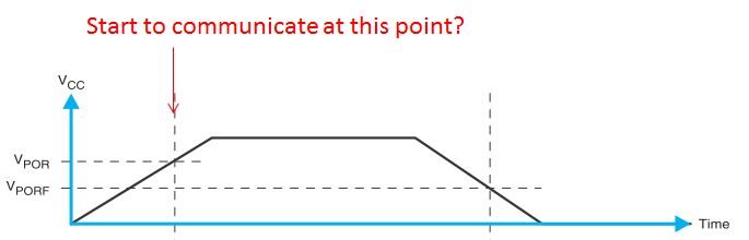

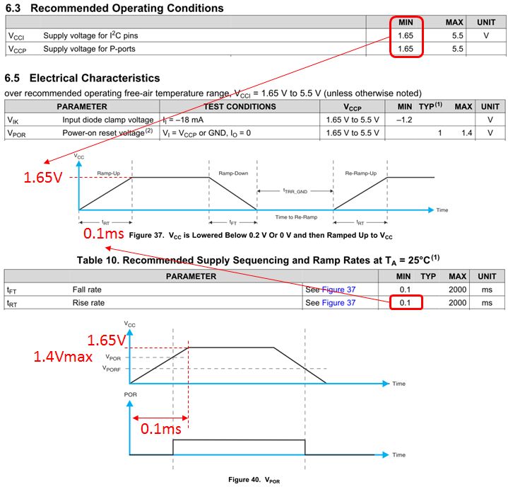

Please let me ask about min/max rise time to VPOR. I believe that the POR should be worked correctly if the VCC range and tFT in Table 10 are satisfied. Is my understanding correct?
