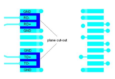

Second question. How much does the backside of the SFP+ cage that stands perpendicular to HS traces to the SFP+ connector have (bad) influence on SI?
We are using HF PCB material and traces from TLK10232 to SFP+ are quite short(about 13mm total). Can this give any problems?

    The TLK10232 is compliant with the SFF-8431 / Electrical standard, where to satisfy the requirements the nominal differential signal levels are ~500 mVp-p with edge speed control to reduce EMI. So, it shouldn't be an issue.
    Regarding the SI issues for the traces, the SFP/SFP+ module connectors are wider and hence have characteristic impedance that is lower than the regular high-speed PBC traces. If the pads are more than 2 times wider than the PCB traces, the pad's impedance needs to be increased to minimize impedance discontinuities. The easy way of increasing the pad's impedance is to cut out the reference plane immediately under those pads so as to have the pads refer to reference plane on lower layers while maintaining 100 Ohms differential characteristic impedance:
