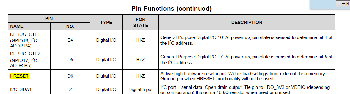

Dear Sirs
What is the voltage level of TI TPS65983 HRESET (pin D6) I/O?
1.8V or 3.3V?
BRS
Nat
  • 1.8V
    Updated datasheets will specify this pin separately for clarification. Please check the SecureSoftware site for the TPS65983 for updates, as the site does not send e-mail notifications to all members.
    Here is the data as it was updated on the TPS65982 datasheet
    Abs Max Rating
    Vi/o, HRESET, Min = -0.3V, Max = LDO_1V8D+0.3V
    HRESET_VIH, Min = 1.25V
    HRESET_VIL, Max = 0.63V
    HRESET_HYS, Min = 0.09V
    HRESET_tHIGH, Min = 2.0ms
    HRESET_tLOW, Min = 2.0ms
