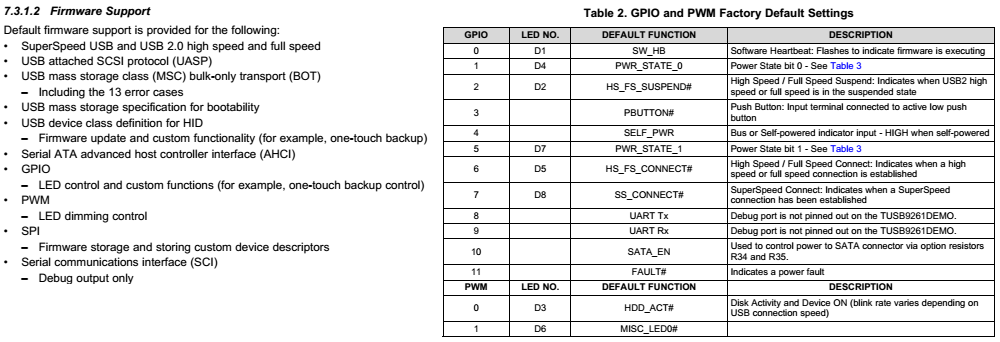

Can you help to support some questions from my customer which are related to firmware of TUSB9261?
<Q1:Firmware for TUSB9261 DEMO Board>:
Does TUSB9261 DEMO Board use same Default Firmware which can be downloaded from TI.com?
In other words, are all of GPIO/PWM pin features described in the table below supported by default firmware?

  • I have checked other post and not can be self-closed...
    The GPIO configuration of default firmware is described at implementation guide as below.
    You may need  to make sure whether the firmware version and description in app. note are matched or not.
    This kind of mismatch often make us busy...: (
    TUSB9261 Implementation Guide
    www.ti.com/.../slla315e.pdf
