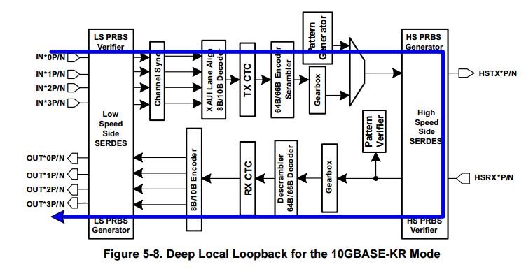

Does TLK10232 have a LS loop back mode? My FPGA send 4 lanes of PRBS code to LS port of TLK10232. And I want TLK10232 just send back what it received.
         What DEEP REMOTE LPBK mode and SHALLOW LOCAL LPBK mean? Where are no more explanations on those in datasheet.

    1. The Deep Local Loopback accepts data on the low speed side SERDES, then data traverses the entire transmit data path, is returned through the entire receive data path and sent out through the low speed side transmit SERDES pins (OUT*P/N). The high speed side outputs on the HSTX*P/N pins are available for monitoring. The high speed side inputs on the HSRX*P/N should be electrically idle (floating):
    To enable this loopback mode, you must enable 0x1E.000B bit[1].
    For REMOTE LOOPBACK AND SHALLOW LOOPBACK modes please take a look into TLK10034 datasheet (Section  5.3.1.17), there are the description of these modes.
