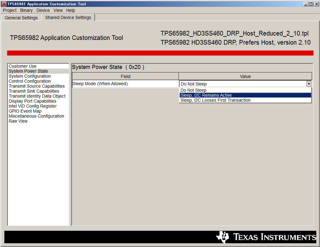

    I would like to ask about System Power State(0x20) configuration when I select the following project.
    TPS65982_HD3SS460_DRP_Host_Reduced_2_10.tpl
    If my customer wants to enter sleep state while the device is unattached or operating in a legacy 5-V application, I believe he should select "Sleep, I2C Remains Active" or "Sleep, I2C Looses First Transaction".
    Is my understand correct?

  • Yaita-san,
    Yes, you can choose either one of these 2 settings. When "I2C Loses First Transaction" is selected, you will use less power than when you Select "Sleep, I2C Remains Active".
    The 3 selections in the Reduced template are similar to the Power Consumption Characteristics in the TPS65982 datasheet, where:
    • Active = "Do Not Sleep" = 0x0
    • Idle = "Sleep, I2C Remains Active" = 0x3
    • Sleep = "Sleep, I2C Loses 1st Transaction" = 0x5
    When you look at the FULL template file you will see another register, Reg. 0x70, named "Sleep Config Register"
    These settings in "Sleep Config Register" correspond to your desired operation, and the last field = "I2C Relax Response Level" is why 0x3 and 0x5 are the values for Idle and Sleep in the Reduced template.
    When you select "Sleep, I2C Loses 1st Transaction" you are setting Reg. 0x70 to value 0x5, which is higher than 0x4, so the system will go to Sleep after 1 second and relax I2C whenever no Type-C connection is active or the 5V load is not PD. The I2C Slave NAKs the first message sent to it, then wakes up for 1 second before going back to sleep, so the same message must be sent a 2nd time to ensure the TPS65982 processed the information.
    When you select "Sleep, I2C Remains Active" you are setting Reg. 0x70 to value 0x3, which is lower than 0x4, so the system will go to Sleep after 1 second  whenever no Type-C connection is active or the 5V load is not PD, but the I2C Slave response will remain active. So all data sent to the I2C Slave will be ACK'd and processed without re-transmitting.
