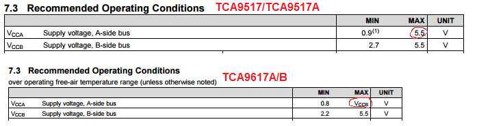

    The design requirements are mentioned on page 12 of TCA9517 data sheet as below.
    So, is the A-side able to be connected the HDMI connector although the power supply voltage on the A-side is higher than one on the B-sinde ?
    Kato
  • Kato-san,
    The portion of the datasheet you are referring to is the design requirements for an example system. It is not stating the requirement of the part, rather than describign the example system setup. I am adding to our back log to have this confusing note removed or corrected in the datasheet.
    The portion of the datasheet you want to look at is the recommended operation condition section.
    It is ok to have VCCA > VCCB for the TCA9517/TCA9517A. The TCA9617A/B cannot do this, though. Please see below snippet from datasheet. You must still meet the power supply requirements for each voltage rail (B side cannot go less than 2.7V, even though the A side can)
    Update: Note that you will need to make sure that the control has to be able to accept the 0.6V VOL as a valid low, because the VOL on the B side is 0.6V max.
    I would recommend having the HDMI connector be on the A side to avoid the compliance testing issues that I have seen in the past. The reason this device can have issues if you put the B side to the connector is because of the testing procedure used, it is not good for any buffers with static voltage offset:
    1) Input signal from compliance tester swings between 80% and 20% VCC to test Capacitance. The test also requests that the device be powered, this means that the TCA9517 has VCCA and VCCB, and is enabled.
    2) When the input on B side (connector side) goes low, it will trip the TCA9517, which will think an external slave is pulling low (voltage is below 30% VCC), and so the A side will pull low to propagate this signal
    3) WHen the A side goes low, it will also trip the A-side input low threshold (Because A side is now below 30% of VCCA). This will cause the B side internal pull down (of the TCA9517) to activate to propagate a signal back through.
    4) When the compliance tester releases the pin to see how long it takes for the voltage to rise (my measuring this rise time, it can calculate capacitance), the TCA9517 B side pull down is still active, and holding the B side low. However, the voltage will be above the VILC value, so the A side pull down will be released and start rising. Once the A side voltage rises above 30%, the B side pull-down will be released and then the B side will rise.
    5) The compliance tester will see this additional propagation delay as capacitance load, and it estimates the capacitance on the line to be ~20 nF (even though this is not even remotely true).
    You can avoid this entire wrap-around delay if you put the A side on the HDMI connector side.
