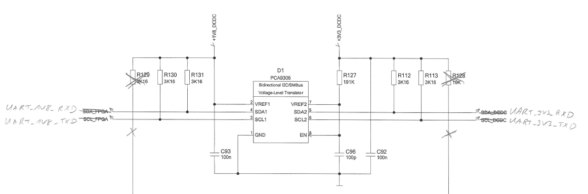

Hello Team,
my customer would like to use PCA9306 in UART mode and translate from 1.8V to 3.3V. Like this:
Would that work?
thanks and regards
Adrian
