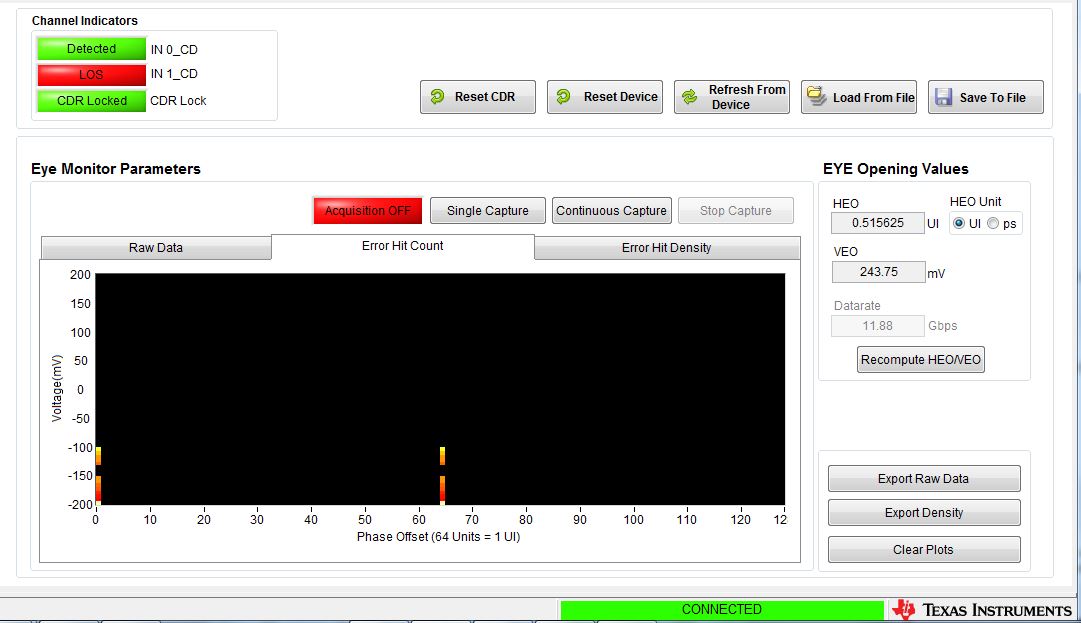

Hello Team.
Please tell me about how to read the EOM from the LMH1219.
It has enabled the following three interrupt .
1)HEO/VEO threshold is reached.
2)CDR loses lock.
3)There is loss of signal(LOS) on IN0.
I will make the reading of this in the EOM counter(Reg0x25,0x26).
Then, it will be the same value can be read from the middle of the 4096 batch.
If I disable the interrupt, this does not happen like that.
It remains Interrupt Enable, or will not be able to read the EOM correctly?
Fukui

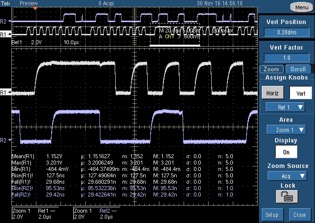

  • Hi Fukui-san,
    I am having trouble understanding your post.
    Are you saying that System B is not able to access the DRV_SCL or DRV_SDA line now?
    Is it possible for you to provide scope shots of the SDA and SCL line so I can see what the signals look like when you try to access the line from System B?
    Michael
  • Hi Michael-san,
    I am sorry I can not explain it well.
    System B has successfully accessed the DRV_SCL or DRV_SDA line.
    I wanted to say that System A does not access the DRV_SCL or DRV_SDA line while system B is using the DRV_SCL or DRV_SDA line.
    Thanks and Best Regards,
    Fukui

    I'm sorry for the late reply.
    I present two scope shots of the Oscilloscope.
    It is from around the start position.
    Both systems A and B are moving on the first sheet.
    Only the system A is moving on the second sheet.
    Please let me know if you have any other points you would like to see.
    Fukui

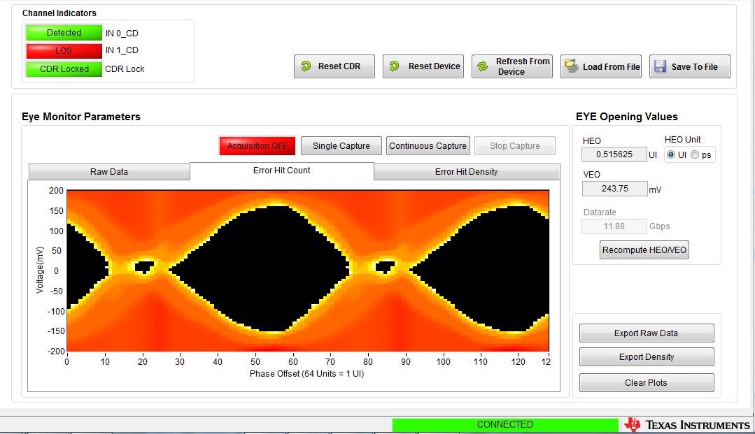

    I spent more time looking into this issue and believe I may know what's going on after reproducing your issue in our lab.
    With Reg 0x56[3]  = 1 to enable HEO/VEO interrupt, I read back the following EOM result in SigCon Architect:
    With Reg 0x56[3]  = 0 to disable HEO/VEO interrupt, I read back the following EOM result in SigCon Architect:
    The issue you are seeing is not related to SDA/SCL line contention as I originally thought.
    There are competing mechanisms within the LMH1219 when both HEO/VEO Threshold Interrupt is activated (Reg 0x56[3] = 1) and the EOM is read back simultaneously.
    - When enabling the HEO/VEO Threshold Interrupt, the LMH1219 periodically monitors the HEO/VEO in order to flag Reg 0x54[3] when the HEO or VEO threshold is not met.
    - If you attempt to run an EOM capture while this HEO/VEO Threshold Interrupt is enabled, a mechanism in the EOM will compete with the HEO/VEO interrupt monitor, since the EOM requires HEO/VEO information to obtain the eye. This results in a corrupt eye capture readout, just like you observed.
    To prevent the competing situation from occurring in the LMH1219 when you read back, I suggest the following:
    1. Disable the HEO/VEO Threshold Interrupt by setting Reg 0x56[3] = 0 before you begin the EOM capture.
    2. After completing the EOM capture, re-enable the HEO/VEO Threshold Interrupt by setting Reg 0x56[3] = 1 again.
    Michael
