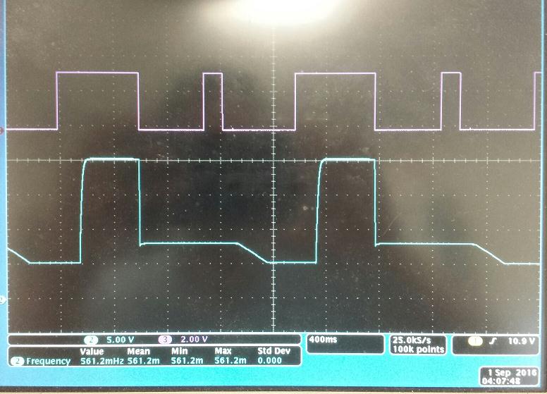

I have a customer who is seeing the TPS65982 “hiccup” even though the current being sourced from the part doesn’t reach the 3A current limit. I am not sure if this is a firmware or software issue but please read the customers comments below:

I did test the circuit with a digital load equipment and setup the load current of 3A and I can see the controller auto-negotiate to 20V power input from USB type-C power supply without hiccup.
Now I adjusted the load to have the inrush current down about 1.5A but the TPS65982 still hiccup with P5V Overcurrent Event show on GPIO #14.  I attached the waveform of the VBUS of the USB Type C input (blue channel # 2) and the GPIO # 14 mapped event of P5V Overcurrent Event (purple channel @# 3 – active low) so you can see the problem.  Is there other way I could troubleshoot the problem on the controller.  I believe that some condition that tell the controller to shut down.  Also during the hiccup I cannot read the registers or communicate to the controller through I2C so I think the controller is in some kind of reset.

Can you explain the soft start function as explained in the data sheet (Section 8.3.3.16)? Is the soft start function only applicable in a “sinking” application? The customer’s application is sourcing the current. Does it only work up to 5.5V? Does this mean if the customer is sourcing 20V that the soft start circuit is not active?

    If the customer is designing the PD Source side of the system, what is the "Actual Load" being used to test?
    Is it another TPS65982-EVM with a Load applied between PP_EXT and GND?
    Did you attach the schematic? I do not see it attached.
    It is tough to tell just from the oscilloscope reading, but it does seem very similar to the "Soft Short" graph shown on page 42 (Figure 28) of the TPS65982 datasheet. It appears that the VBUS voltage is being throttled to limit the current, and because the condition does not resolve on its own, the PD contract is being aborted and VBUS drops to 5V.
    Is there any way to use a Current Probe to plot the load current on the scope also?
    NOTE: You are correct that Soft Start only applies to the Sink side, and the Source will ramp from 5-20V as fast as possible.
    It appears the Source is capable of ramping to 20V, and then the load is applied harder after ~400ms.
    How did you "adjust the load to have the inrush current down about 1.5A"?
