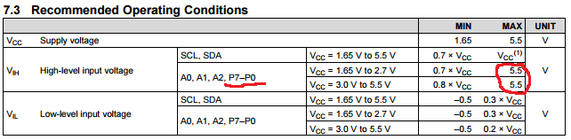

Wanted to confirm if the only way to enter High-Z on the TCA9554/A is by setting them as inputs?
Also, do you see any issues with powering up this device with +1.8V and pulling up an I/O pin with 100k to +3.3V, as long as we ensure the I/O pin is either an input or a low output?

    You are correct that the only way to high-z the pins is to set them as an input.
    However, the TCA9554[A] has internal 100k pull-up resistors to VCC, so it would not be a good idea to pull up to 3.3 with an external 100k resistor.
    If you want the same functionality as the TCA9554 but without the internal 100k pull-up resistors on the ports, try looking at the TCA9534[A]. It's the exact same part, but without the internal resistors on the P ports.
    With the TCA9534[A], it is OK to over drive the P ports above VCC (up to 5.5V). This is shown in the recommended operating conditions on the datasheet. If it were not OK to put the input above VCC (for an ESD diode, for example), it would have the max listed as VCC.
