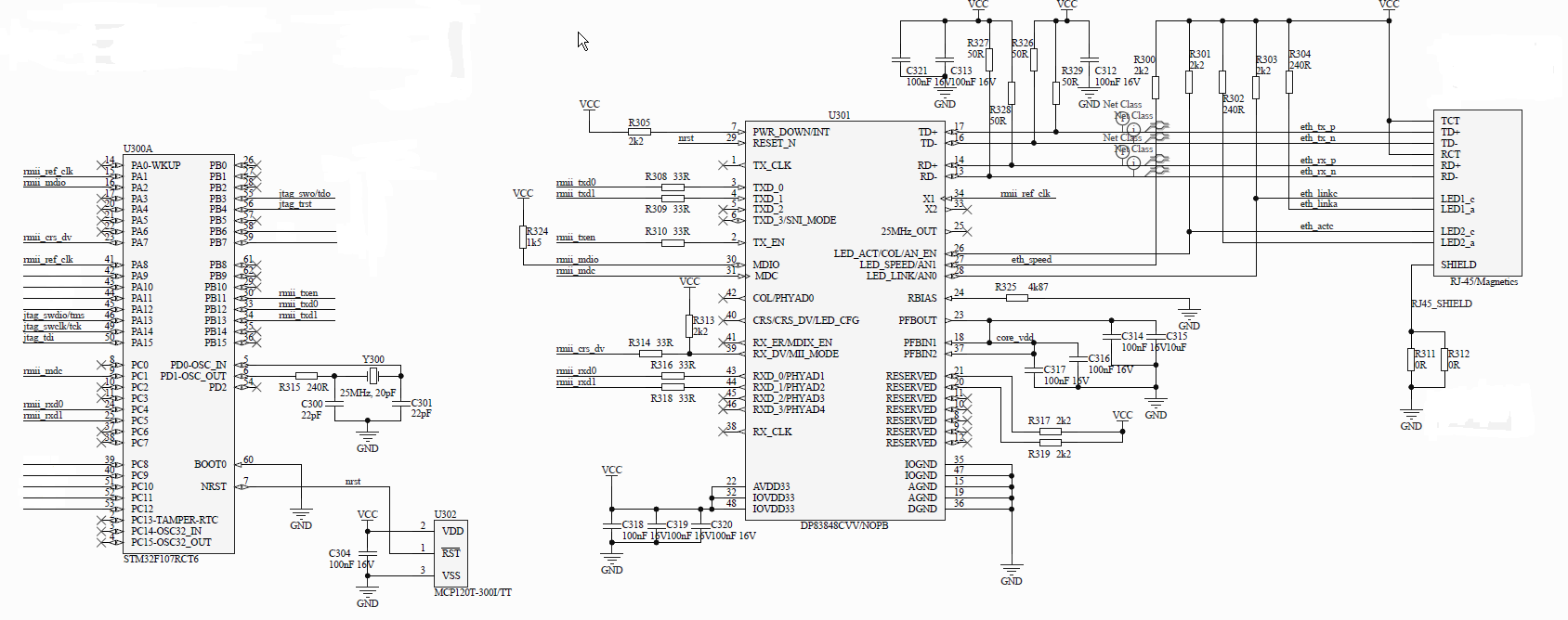

Some of my prototype boards using an DP83848C have this TD signal shape at the CAT5 connection and do not transmit correctly. The signal is similar before the magnetics. Any ideas where I should look for the problem? The BIST with internal loopback fails. The receive path is fine, and the Tx/Rx signals were impedance matched in Altium.
