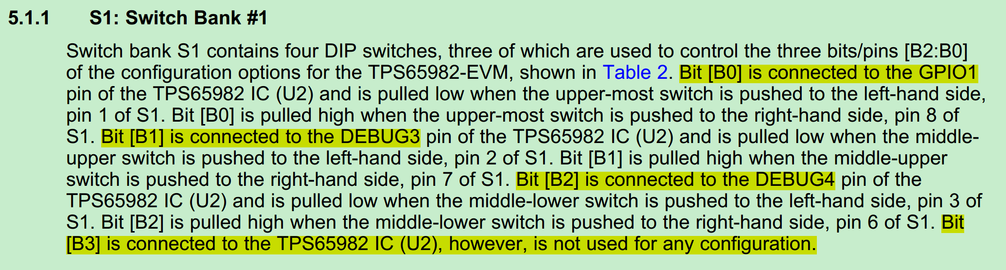

Hi Team,
I can not find the answer in the TPS65982 datasheet or EVM user guide that why the S1 DIP switch can control the configuration of TPS65982. What is the mechanism?
Best Regards
Nic
