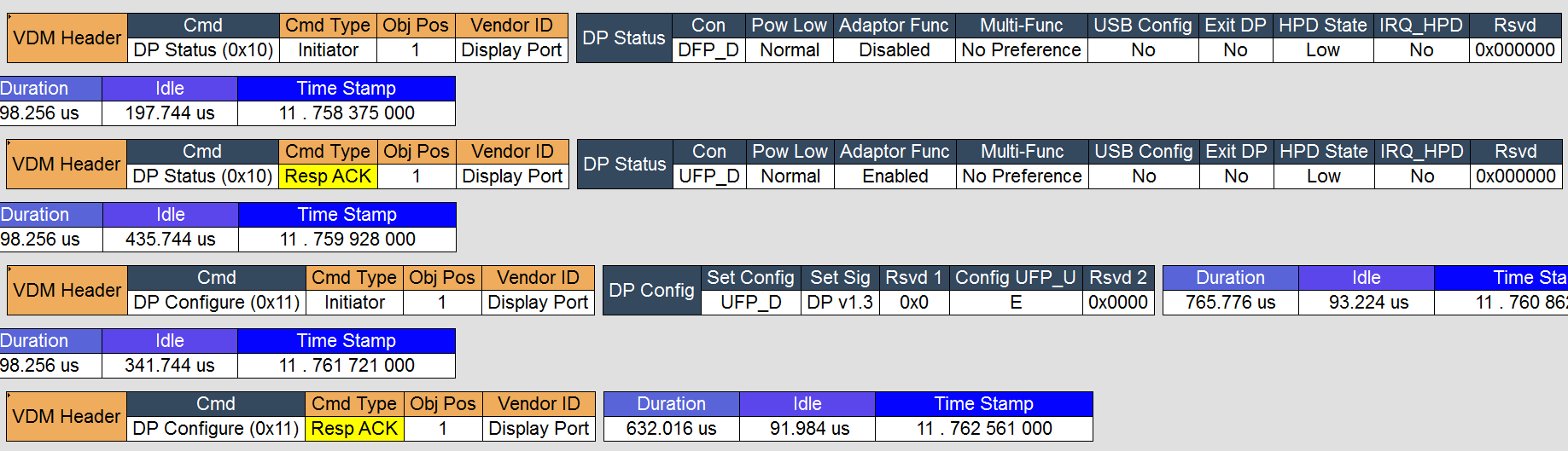

Hi Team,
I get below DP VDM from the CC Analyzer. But I can not find any explanation of these messages in the Type-C or PD2.0 Spec. For example, what is the meaning of DFP_D? Would you tell me where to find the explanation?

  • Hi Rahul,
    I have got the DisplayPort v1.3 Spec. But I still can not find any explanation of the grey VDO(DP Status Cmd & DP Configure Cmd)shown above.
    What's the definition of the terminologies such as Con, Pow Low, Adaptor Func, Multi-Func, USB Config, Exit DP, HPD State, IRQ_HPD, etc. ?

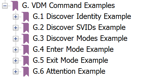

  • Hi Nic,
    Please check "Section G. VDM Command Examples" of USB PD spec.
    Some of the terminologies which I remember is as follows:
    Exit DP: This command says to exit the DP mode
    HPD: Short form of Hot Plug Detect, this signal indicates whenever a display device gets connected to the system
    HPD State: says current state of HPD
    IRQ_HPD: the interrupt which deals with HPD event
    Rahul

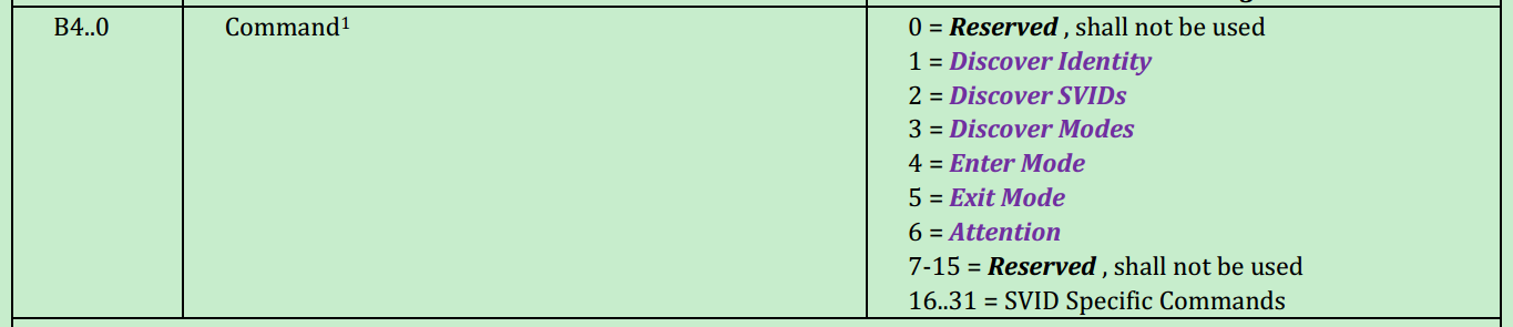

  • Hi Rahul,
    "Section G. VDM Command Examples" just contains commands that defined in the PD Spec. SVID specific commands can not be found in the PD Spec.
