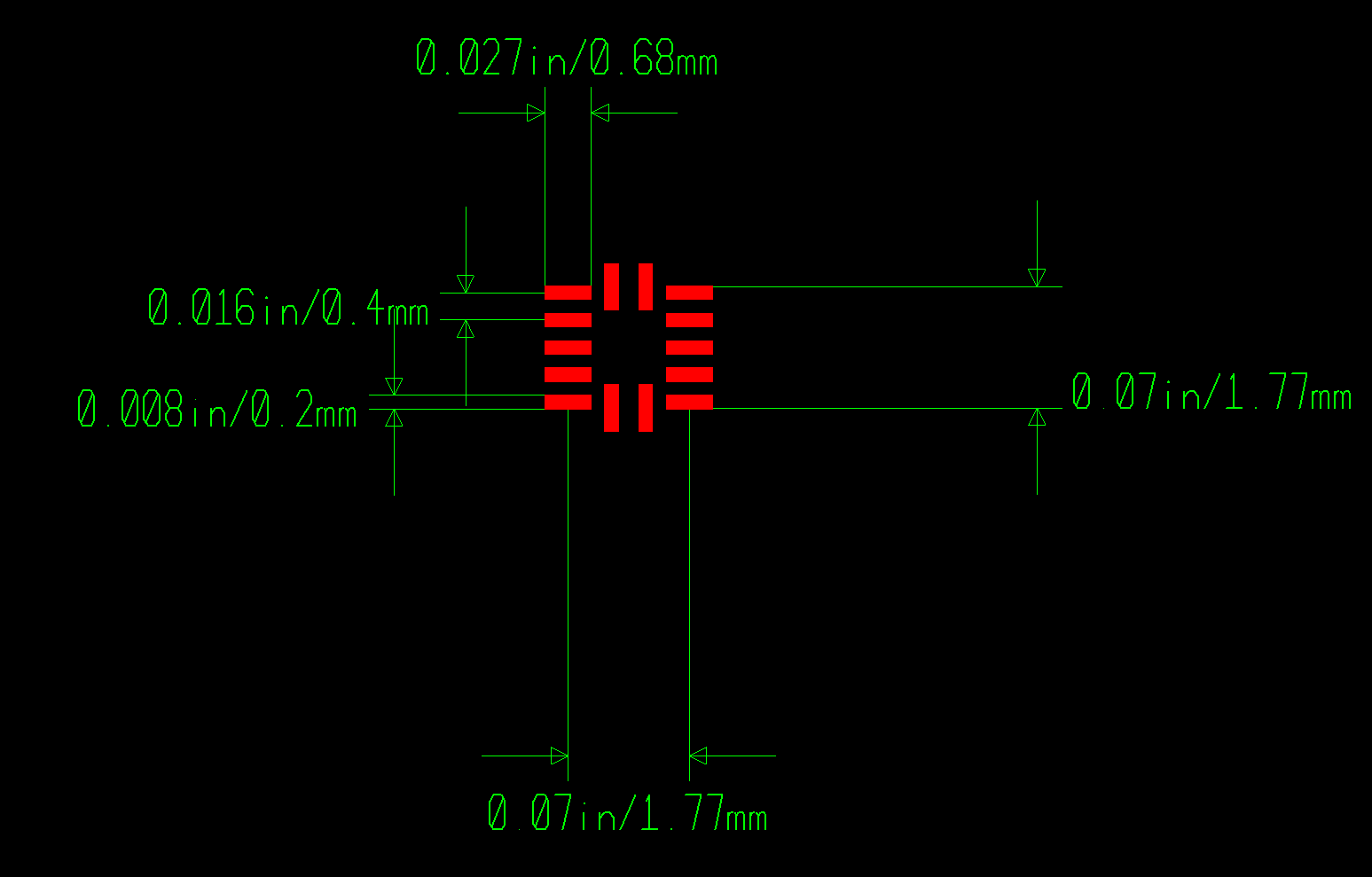

Hello, for the TPL0102-100 (X2QFN-14 or RUC Package), what is the recommended land pattern? I can't find much information on this specific package.

Hello DMor,
I have attached at image of the footprint for the X2QFN (RUC) package.
You can get almost all schematic symbols and footprints using Accelerated Designs free tool. Here is the link.
Let me know if you have questions.
