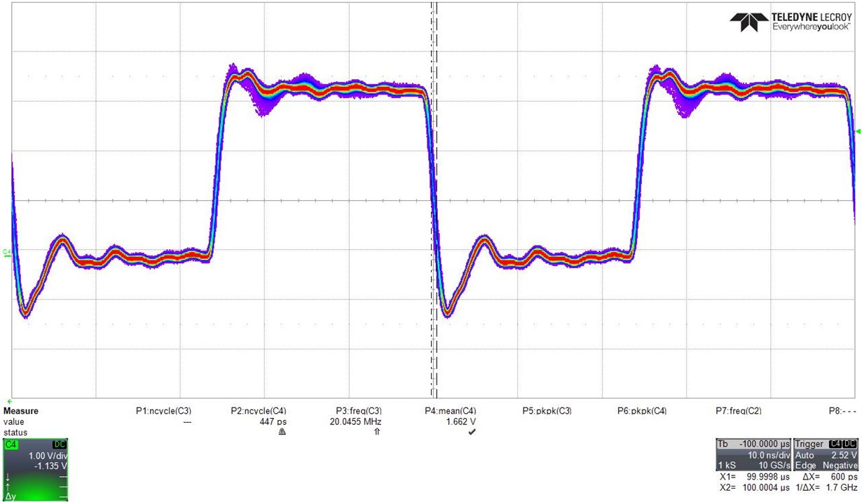

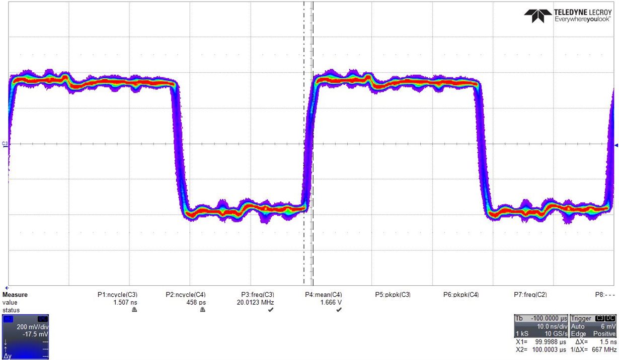

I'm working with a DS90CR287 chip and I am seeing dropped clock cycles on the output clock (TXCLKOUT) when running at 20MHz, which is the minimum spec'd clock frequency. There is significantly more jitter on the output clock than I would have expected (~2ns) considering the input clock is incredibly clean. This seems to be causing problems with one of our frame grabbers. Is there anything that would be causing the poor output clock?

    Single-ended input clock @ 20MHz
    LVDS Output clock @ 20MHz
  • Hi Dan,
    I only recently realized that this thread has gone unanswered since your last post. I apologize for this! Has there been progress made with this issue?
    From the output of the LVDS clock, it seems reasonable, centered at 0-V differential and about 750-800 mVpp. The media length also should not be an issue, since 3 ft is a short distance. If this issue has not been solved, do you see an improvement if you try replacing the DS90CR288, or is it reproducible on every DS90CR288 IC? Same question for the DS90CR287. I am wondering if this may be an issue of one IC not having enough margin while another IC does.
