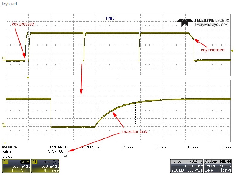

  • I'm not surer I was clear in my precedent message.
    Here is a screen capture of a Line with 2x470pF (and 2x470pF on the col).
    I measure 343µs, which is obviously too much.
    With 2x47pF the rise time is around 10µs, but i still detect ghost keys.
    With 2x10pF everything seems to work properly.
    So, I wonder what is the maximum input capacitance a line can manage.
    Or, on the following capture, what is the maximum acceptable rising time?
  • Hello Sylvain,
    Thanks for the clarification, I understand what you're asking for now.
    We do not have a specification for this scanning speed. I would expect the maximum allowed delay to be near 50-100 us.
