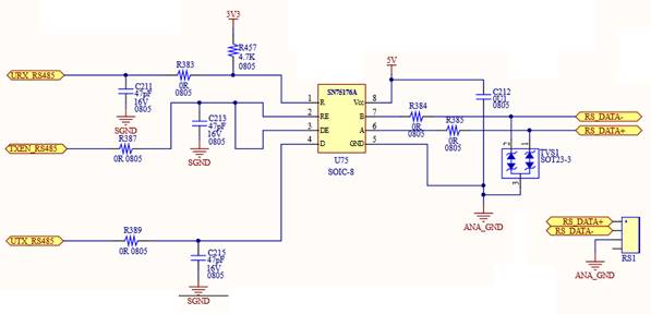

One of my customers faced an issue using our SN75176 for their RS485 communications.
Here’s the summary of the issue that they were encountering with the SN75176:
Master:
  • ·         Baudrate: 115200
  • ·         RE Pin: Tied to GND
  • ·         DE Pin: Tied to VDD
Slave:
  • ·         RE Pin: Controlled by MCU
  • ·         DE Pin: Controlled by MCU
Master
Slave
Remarks
SN75176A
SN75176A
Master cannot receive correctly from the slave.
Slave can receive data from the master correctly.
SN75176B
SN75176B
Doesn’t communicate correctly.
Here is also the schamtic of their master and slave:
Master
Slave
Please help advise on what can cause this issue?
