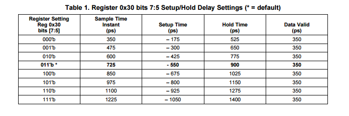

  • Another question was regarding this timing app note. In 'Section 3: Serializer Register Programmability' it shows this table and identifies the default register setting for sample and hold times:
If they have a data valid period of 800ps on the sensor spec and factor in skew for cable (40ps), and clk buffers, and a lane to lane skew of 50ps, what type of setup and hold time would be safe to program into the serializer for their setup? Given all this, would it be alright to remain with the default?

    2.  Is it possible to see a parametric table and timing diagram for the FPGA that is driving the TxIN and TxCLKIN of the serializer? I think I understand this question, but want to make sure. This table allows you to sample the data within a 350 ps window, and it simply means that this window is shiftable, depending on where the incoming data from the FPGA is guaranteed to be valid. If I assume that the cable and lane-to-lane skew affects the left and right margin of each bit equally, I can assume that there is (40+50)/2 = 45 ps skew on the left-side and 45 ps skew on the right-side, like so:
    Since you have an 800 ps data valid time, I predict that you will need to ensure that the DS32EL0421 setup time is greater than (45 ps + FPGA min. setup time) to ensure that the beginning of the DS32EL0421 sampling window occurs after the FPGA input data is stable.
    Since I do not have the customer's setup-time, I am not able to estimate this, but hopefully the information above gives guidance about how to determine an appropriate setting here. To me, the default 550 ps wait-time after the clock's rising/falling edge should be sufficient to begin sampling data.
