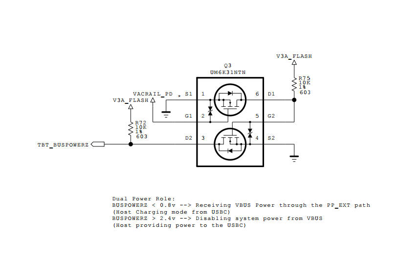

There is an issue that HV_GATE1 is not driven when PP_EXT power is negotiated.
It only happens when the Dead Battery condition and when there is 3~5V on SENSEP of TPS65982 which is not discharged yet.
Can you explain why it doesn’t drive external FET?
If the PD controller keeps monitoring VACRAIL_PD to protect reverse current, can we adjust the allowed level of VACRAIL_PD for PD to drive FET?
