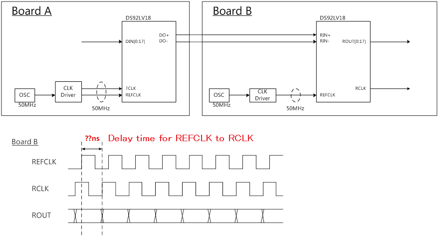

Is there delay time spec of REFCLK to RCLK for DS92LV18?
Waveform image is below;
Satoshi

    There is no specific parameter that specifies a min/typ/max for the delay time from REFCLK to RCLK.
    However, since the REFCLK is simply just a reference to help the deserializer PLL achieve lock, I think the more critical parameter here may be the delay from the time the SYNC patterns arrive to the time lock is achieved and both ROUT[0:17] data and RCLK clock output become valid. This parameter is specified by tDSR2 (p. 5) in datasheet.

  • Satoshi,
    For the DS92LV18 deserializer there is no required phase relationship between the REFCLK and RCLK.  The REFCLK is only required to be within 5% of the incoming data-rate recovered clock frequency to ensure the LV18 correctly deserializes the input data.
    Datasheet propagation delay specifications assume a valid REFCLK input is present prior to the DS92LV18 beginning lock acquisition.
