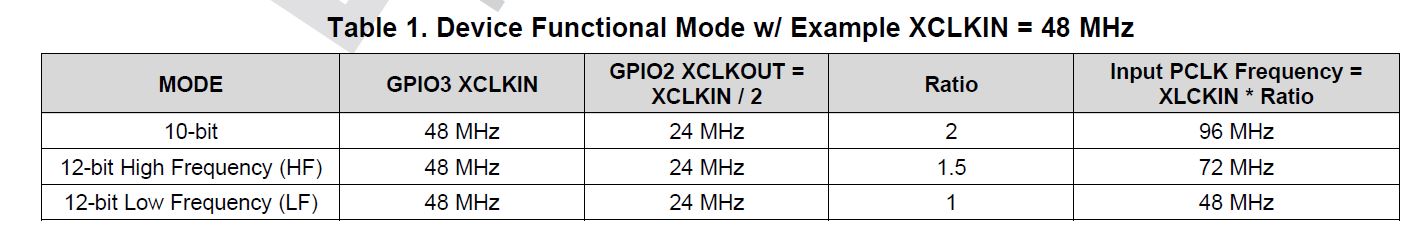

    1. In BIST mode, the internal clock being used is relatively low (~ 12.5 MHz) and this would need to be changed for your customer's specific system use-case in 10-bit mode. You can evaluate BIST either with external oscillator/PCLK or with internal PCLK. In order to evaluate with external oscillator like that being used in customer system, the GPIO[1:0] on 914A must be set to 0 (see below table). I also provide the info for performing BIST with internally generated PCLK below:
    If the customer is using 48 MHz clock, then input PCLK should be 96 MHz going into 913A device. In this case, we should set internal BIST clock to ~ 100 MHz. This can be done by setting BIST register 0x24 = 0x03  to enable BIST mode through register (not device pin) with PCLK of ~ 100 MHz in 10-bit mode.
    2. No initial register settings are needed; all default registers are set accordingly for proper system operation upon power-up. The only thing in your customer's use-case that needs to be set is BIST internal clk as shown above.
    3. Please see the 913A and 914A datasheets for this description and more information. This depends on the divider settings. For 48 MHZ clock which they are currently using, please see the below table. You should be able to deduce the proper values if instead of 48 MHz, they were using 36 MHz. Simply substitute 36 MHZ into the equations below:
