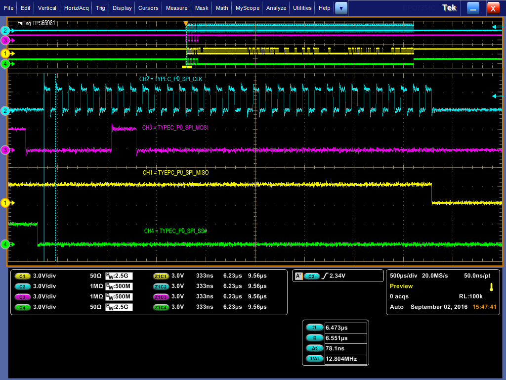

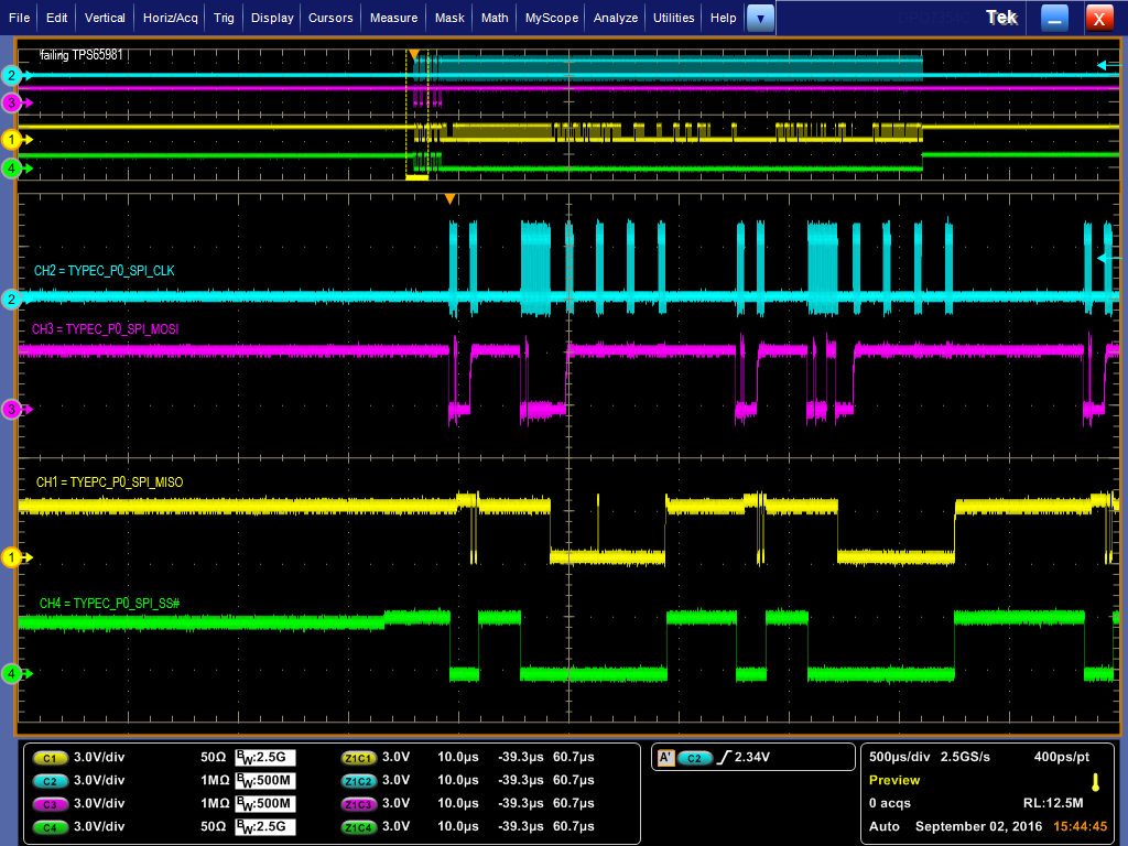

  • The device is question is the TPS65981.  There are no UART pins, unless these are brought out on other pins in a debug mode.  Please advise.
    Attached are scope shots showing the activity on the SPI bus:
  • Hi Ronnie,
    Thanks for sharing the plots.
    From the first plot we can see the the first 4 bytes stored in the SPI flash is 0xFF, 0xFF, 0xFF, 0xFF; which is highly unlikely.
    Can you share your bin file and configuration details.
    By looking at the problem statement and the waveforms it looks like because of some reason TPS65981 is not able get valid data from SPI flash.
    Please share the bin file and configuration files along with the schematic and layout files.
