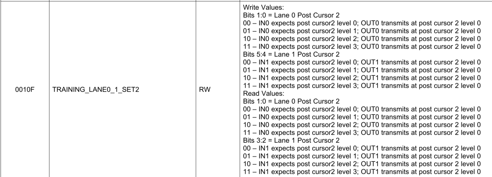

Let me confirm about below.
According to datasheet of SN75DP130, there is following description.
This register shows that post cursor 2 function can be set only level 0 ( I believe that level 0 means 0 dB).
Does it mean that this device does NOT support post cursor 2 function ?
(The reason why that I thought such as above is there is also no description about how to change post cursor 2 level and information about post cursor 2 level itself.)
