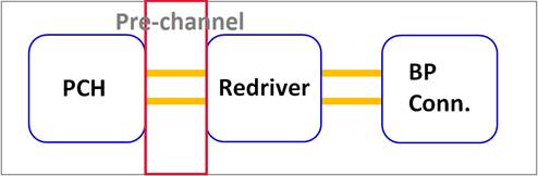

    I have a follow-up question. The customer would like to know where or not the design can work. The block diagram is shown below (Note: The redriver is DS125BR820). The customer has calcuated the pre-channel loss (From PCH to redriver) is less than -14dB (includes driver compensation). The customer would like to transmit data using PCIe gen 3 and SAS 12G. Please advised. Thank you for your support.

    A pre-channel loss of -14 dB should work well with the DS125BR820 in PCIe Gen 3 and SAS-3 applications, as this is more than the minimal amount of CTLE boost setting when DS125BR820 EQ = 0x00. When you say "less than -14 dB," how much less is it? Will there be at least -5 dB loss?
    Also, can the customer comment on how much loss is expected after the redriver and before the connector?
