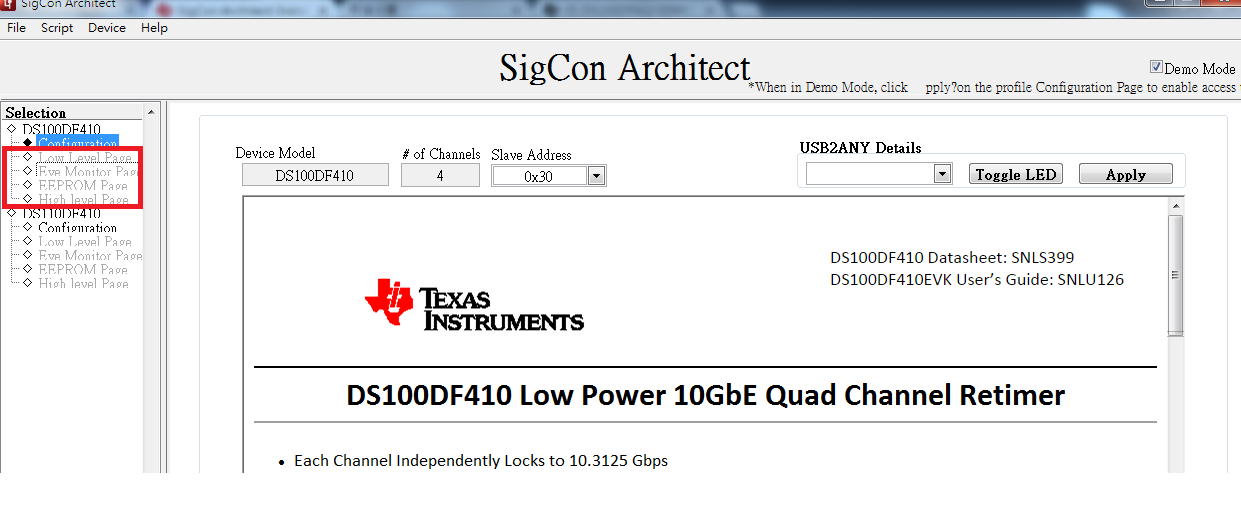

  • Hello Michael,
                   Thanks for your reply. But I meet a problem on below red mark while run Profile Updaters of DS100DF410? Do you have any comments for it? Thank you.
    BR
    Patrick

  • Hi Patrick,
    To resolve the issue you are seeing in SigCon Architect, click "Apply" in order to unlock the grayed-out pages.
